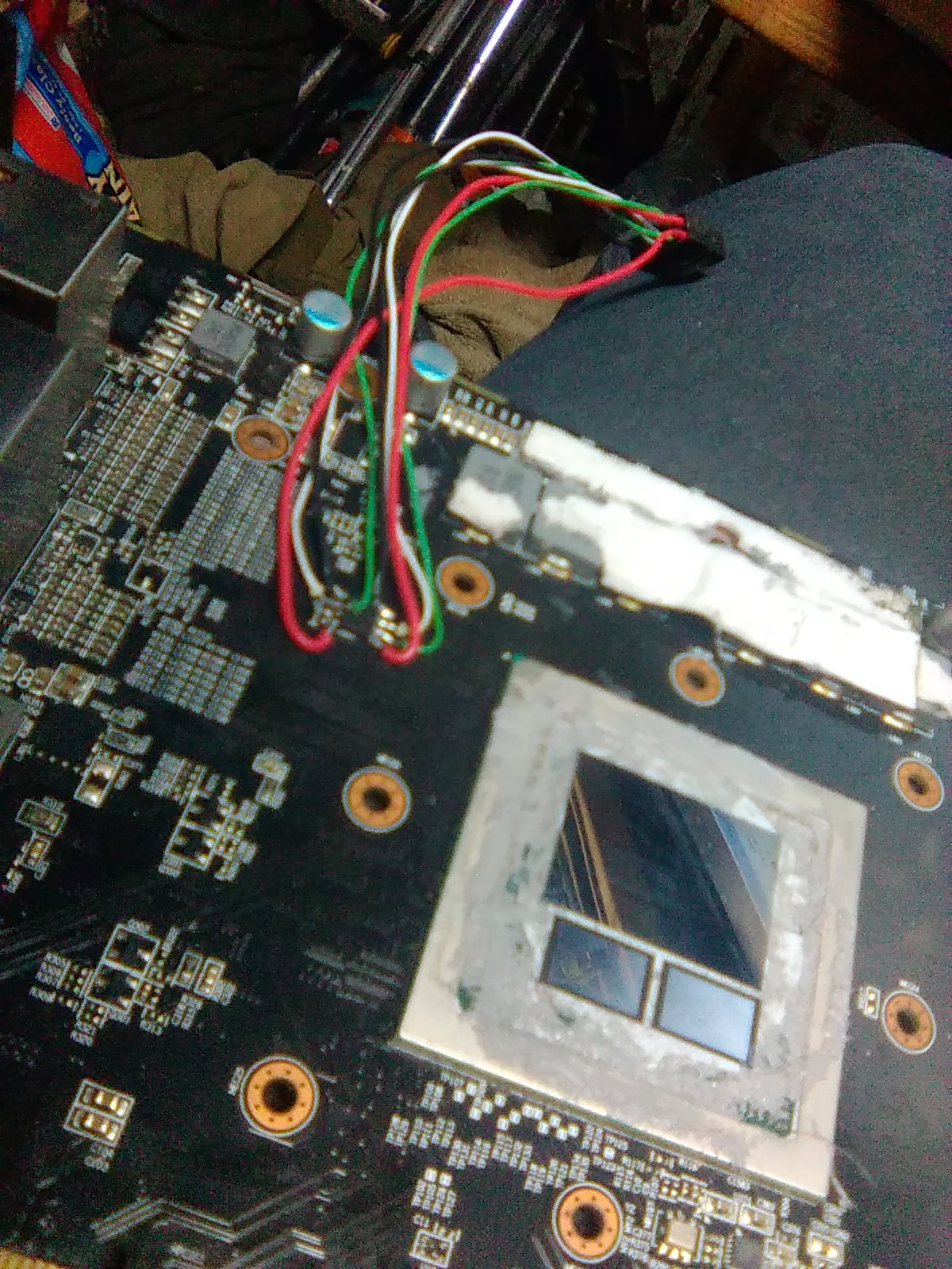

Update on this. It appears that the crash is happening after GIM delivers the blob payload as linked above and then attempts to read it back. A friend of mine added some additional debug messages to GIM (basically just some printf around where we crash). I know the EEPROM is called “dual/quad” because it has a few different storage modes/regions.
In the screenshot above you can see GIM reads RLCV option ROM version 113 but wants to patch up to version 129. My guess is that it might be possible (perhaps) to preemptively patch this firmware somewhere in the EEPROM (assuming that’s the chip where it’s stored) so that GIM doesn’t need to try to flash it during modprobe as the blob version dependancy would already be satisfied.
My guess is amdvbflash isn’t able to flash this region as I’ve tried dumping and reflashing various VBIOS images I pulled off real s7150 GPUs to this w7100.
Next I guess I’ll try reflashing it via FlashROM and see if I can somehow force this RLCV option rom to load since amdvbflash doesn’t seem to have the ability to affect this.
With additional debug messages added to where the fail seems to happen.
These added printf messages might indicate the read is the problem. Maybe we can just write it and not bother to verify the result of the write and otherwise continue execution. Will report back if that works. Any help would be much appreciated!
