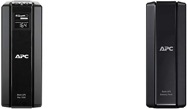

I think a UPS (Uninterruptible Power Supply with Surge Protection and Battery Pack) does that, but I am sure someone will correct me.
I highly recommend getting one either way. UPS devices are rated in VA, not Watts which is different and confusing. This 1500VA UPS translates to 865W, read the fine print before you buy. A UPS or 2 to handle all of your needs may be expensive.
My current UPS can only handle my PC (390W) and I plan to get a better 2nd one, then I will use the old one to protect my screen and peripherals.

It would allow him to draw more current before the fuse breaks, but that's completely different from what a UPS does so the cost/effectiveness comparison is questionable. As far as I know a UPS would only protect him against surges and deliver a "smoother" current for the PSU. And if all of the devices on the outlet group for that breaker fuse (cumulatively) draw more current than the fuse is rated for, it's going to pop.
A UPS wouldn't enable him to draw more power than what the breaker fuse allows. Not to mention that the UPS (and the UPS fuse) should always be rated at "less than" what the fuse at the breaker can handle... (edit: ...which means that the in-build UPS fuse would pop long before the circuit breaker one does). Besides, adding a higher capacity fuse would make him more susceptible to damage from power surges in the grid (or from a lightning strike).
