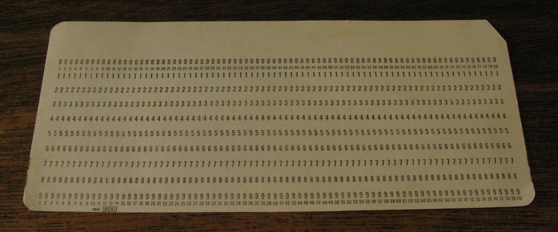

No-Tech Solution:
Paper lasts shockingly long time spans. I have some punch cards for a long defunct IBM-system with clearly legible text on them (60+ years old).
This. The only way to keep information “alive” is to update it religiously, on many different types of media.
I just pulled this one from of one of my drawers. :wink: Paper is surprisingly resilient, as long as you keep it in a climate-controlled space.
