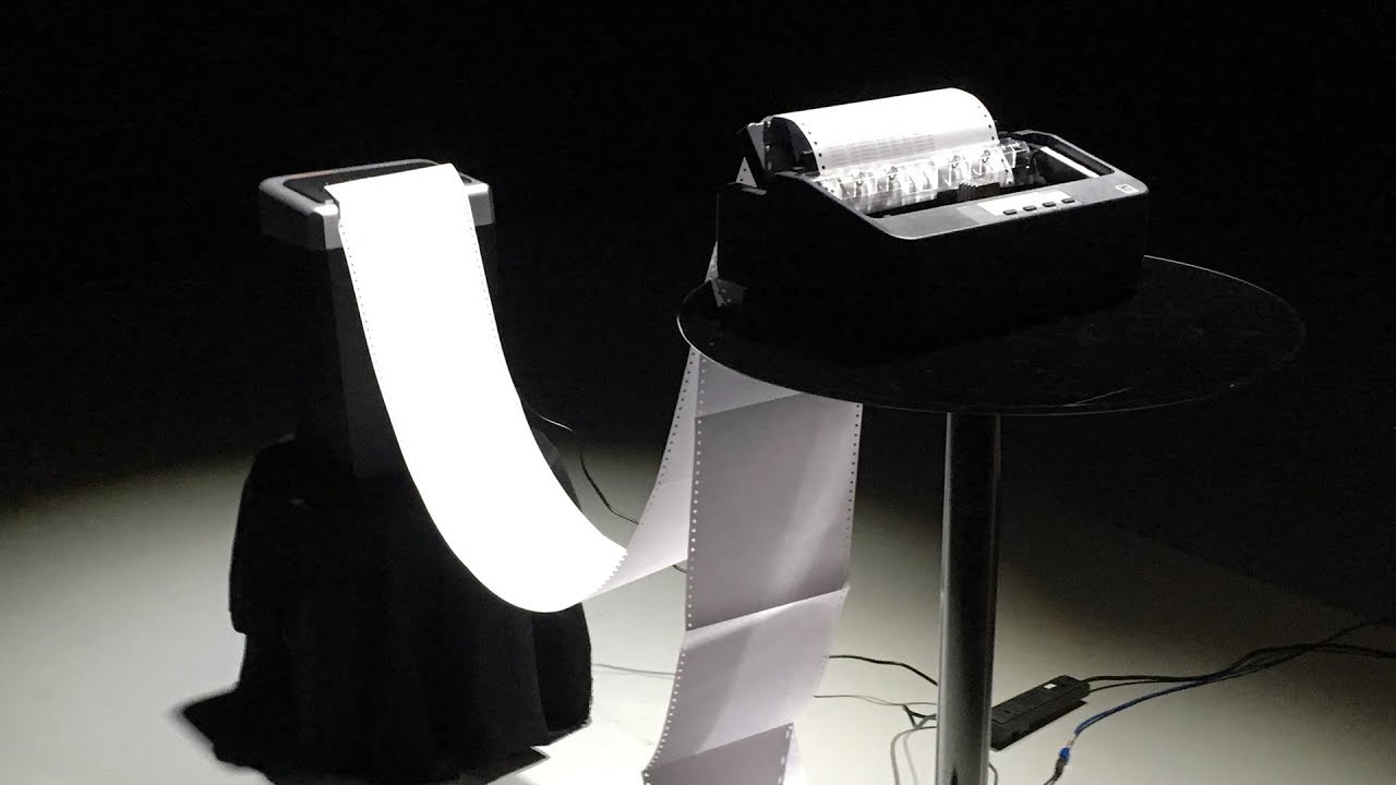

Ooh can you get a dot matrix printer that works and a box of perforated paper? I mean box, they probably don’t come in rolls.
Those are still a thing?
That is what I am wondering. I guess someone still makes em. But theyd be pefect, if you had some drivers and just needed to post a string to them.

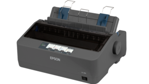

They are called impact printers it seems. Epson still makes them.
eg:
https://epson.com/For-Work/Printers/Impact/LX-350-Impact-Printer/p/C11CC24001
