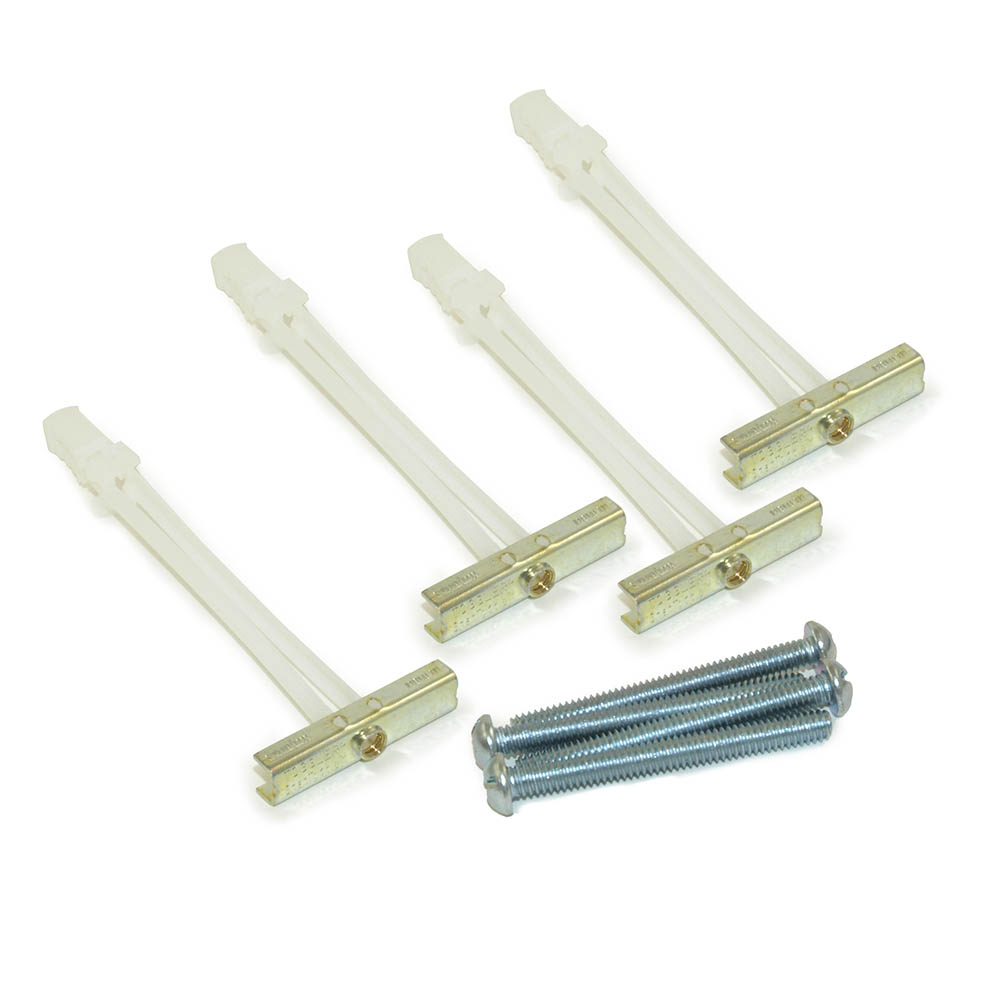

if i were you i would wall mount using these
going through the stud. and use a wall mount on a arm. the main reason is large tv's fall easy and break easy so mounting to the studs themselves is the best way. if you use a 18 in wide shelf it may be fine or it may someday fall and at 72 inches it wont survive.
