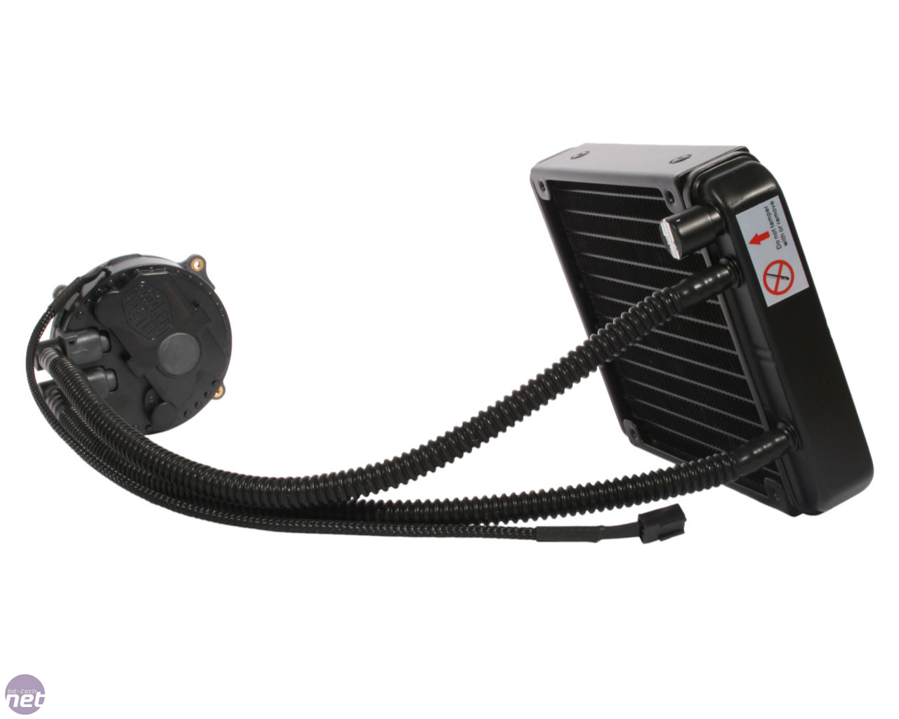

Hi everyone, I own a 3 year-old Cooler Master Seidon 120m AIO (this is its website)

I think it can be refilled, check this picture
I've never touched but I'm guessing that's the refill port.
Edit: That thing won't loosen, I tried to twist it by hand, like a water bottle. It think it has glue or something :S
