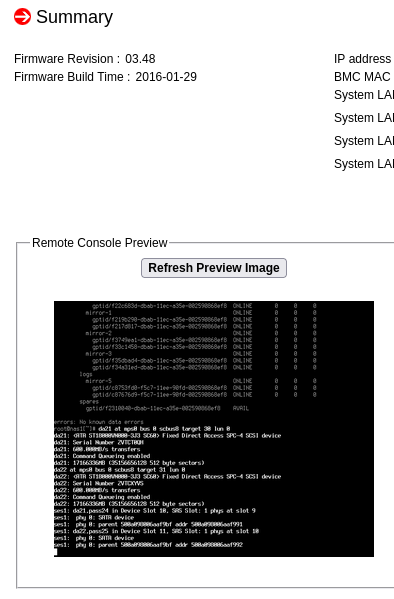

Update BIOS for IPMI Users
For us turbo nerds who buy rack servers off of eBay and use this board we need to enable the ability to update the BIOS by entering a product key. Don’t worry you don’t need to actually buy anything. All you need to do is download this handy script someone wrote in Perl to spit you out a valid key. Just supply it the MAC address of your BMC and plug in in and you’re good. This is under the maintenance tab.
Download it here → GitHub - bwachter/supermicro-ipmi-key: Generate keys for supermicro IPMI (give them a :star: while you’re at it)
EG.

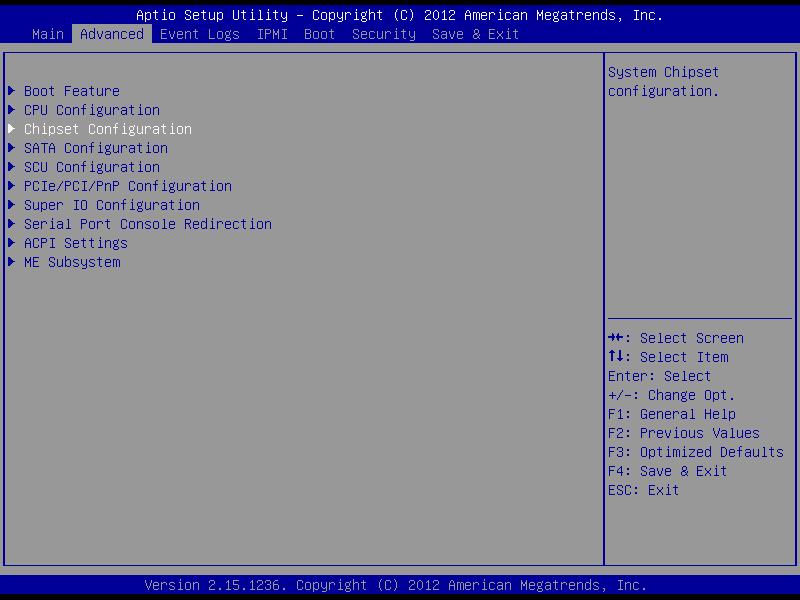

Enable Bifurcation
Go to the Advanced tab and select the third option, Chipset Configuration.
Now select North Bridge.
Now, Integrated IO Configuration
On the bottom half of the page you can now configure your PCI slots how you wish.
Enable the bifurcation. The IIO section above the slot is the setting that controls the corresponding slot. In the example below you can see me set it to 4x4x4x4.
In summary, starting from the beginning this is your path:
Advanced > Chipset Configuration > North Bridge > Integrated IO Configuration
