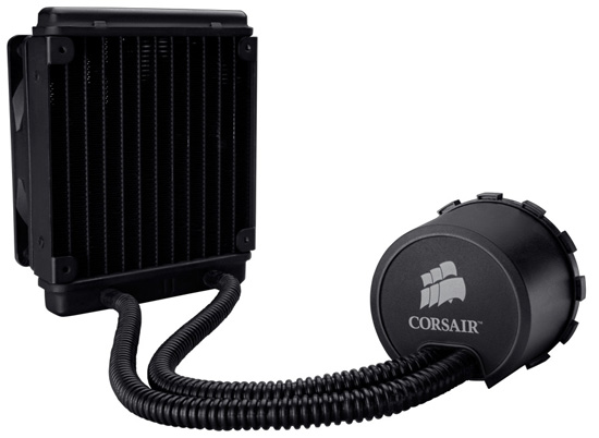

maybe some water cooling hack would work. from what I've seen of most laptops if you replace the heatsink with a copper plate you could attach water cooling to that.
note you'd need a external keyboard,mouse, & monitor and to flip the laptop upside down with no bottom panel obviosly.
