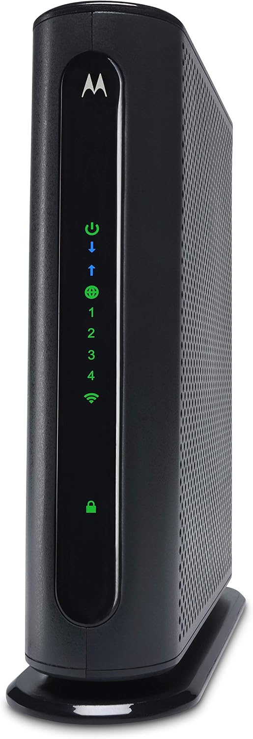

As previously stated, avoid the modem/router combos like STD's.
This one you linked under it
is lame at that price. What determines the amount of throughput on modems is how many dedicated QAM channels for the Down/Up it supports. That one is only 8/4, where this one, that is only 5$ more
Has 32 on the down and 8 on the up. This is significantly more throughput.
So the more, the better.
Lastly, just make sure the modem supports DOCSIS 3.0 and those are really the only 2 requirements for a good modem.
