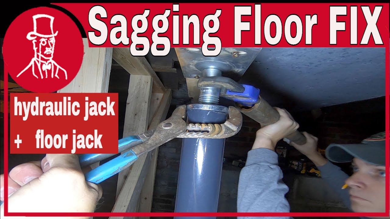

What’d you end up doing? Pull up floors and throw some floorboards down
we used telescoping floor jacks and we jacked them up using a bottle jack, once its at the appropriate level we placed another telescoping floor jack at the appropriate height and some wood to make it exact
I can’t speak for the guy’s technique or advice as I didn’t watch the whole video, these are just the telescoping jacks we used

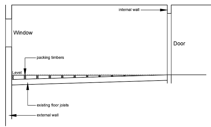

It’s just a thought, but perhaps get something like this, so you can gauge what the levels are doing.
If you didn’t want to do that, at least get a marble and a flat sheet of any material you have to hand.

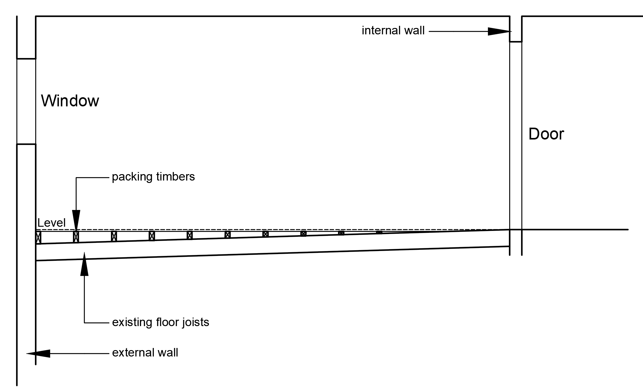

If you went for the laser, mark out the highs and lows, if you were lucky for instance, it would be high near the door and low near a window / where your desk is. You could do something like this:
It’s most likely that the slope is in the direction of the joists, that are at 90 degrees to the floor boards that you walk on.
It would be handy if you had a floor plan or photos, I’m making a lot of assumptions without knowing if it’s a masonry build, though I’m guessing as you’re in the US, it’s more likely a stick build (timber).
It might be good to do all of the whole first floor and see if the levels are off for both the back and front of the house, using the laser and pencil marking the wall to move a fixed datum.
