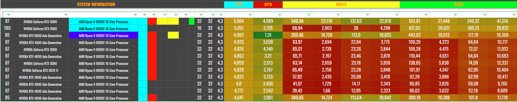

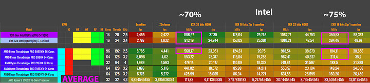

Thank You mate! btw You will publish results on Pxf spreadsheet? I could try update excel shreadsheet with your results and your nick name, is it okay? or you will do it later on, just let me know :grinning: Cheers!

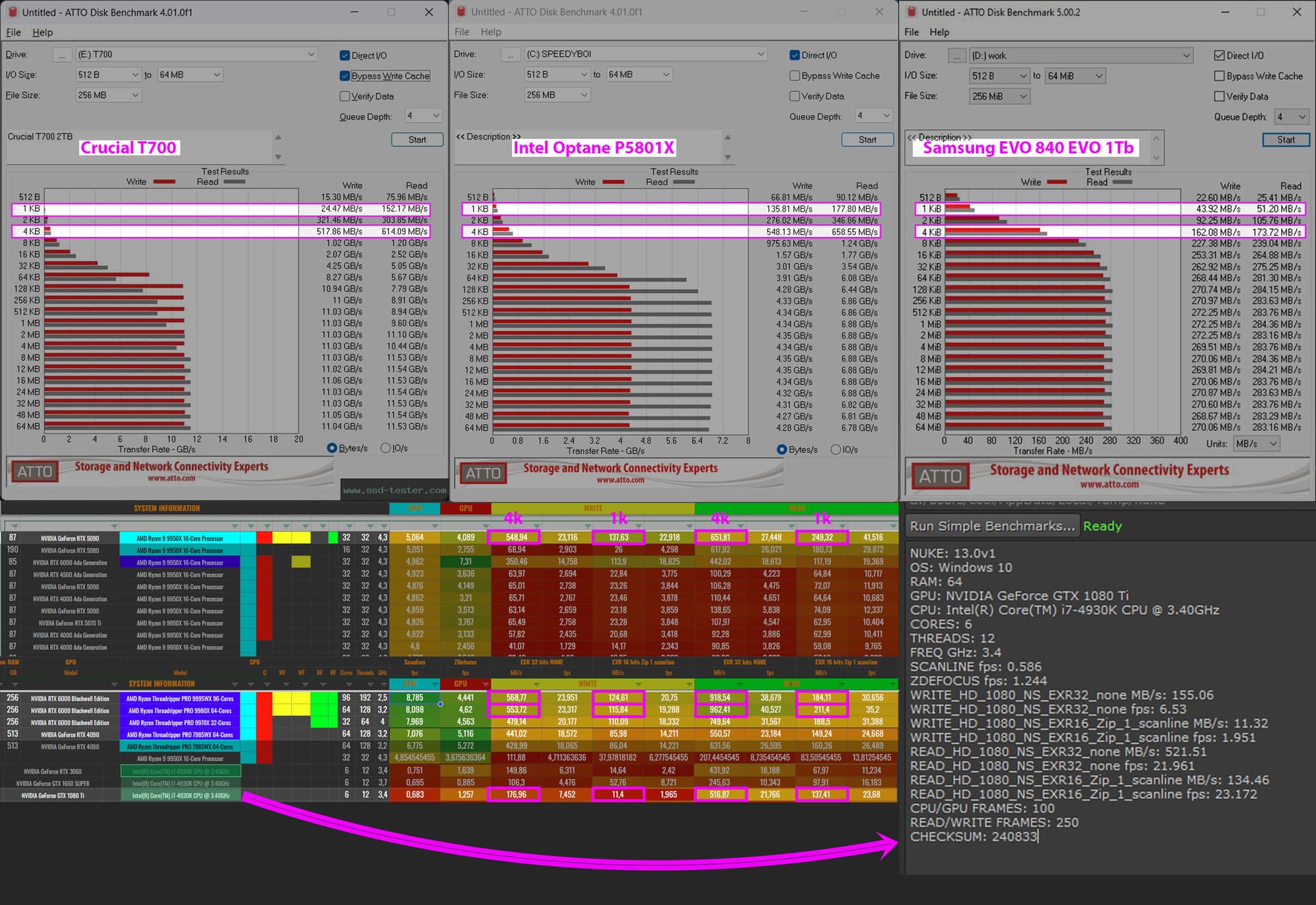

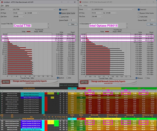

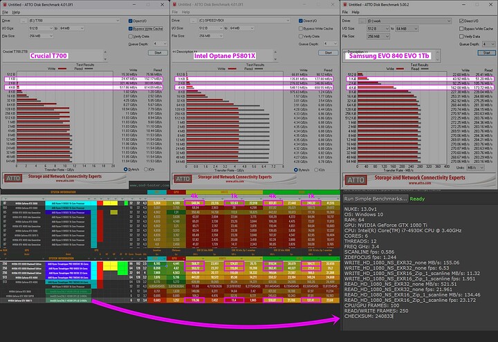

EDIT: Also what is SSDs been used? just looking around other SSDs in Spreadsheets, and did some average(also saw same CPU have very very different results), and I think Write and Read speeds really is depends what is SSD is. I don`t know if You have much time, or possibilities You think it is possible make a test with intel optane p5801x or intel optane p5800x SSds, just wondering if it make aaaaaany sense in this nuke test, or like option ASUS Hyper M.2 Card with raid ssds, but yeah it is up to You (I know I know I am so many ask haha, but thank You and Wendell soooo much for all test what is been done, and very surprised with results).
just got as ref 9950x just for SSD results (and unfortunately it is no info about ssd in tests)
but it is clearly see same CPU(I think it is variations in Overclocked or cooling in compare and different GPU and SSDs )
Heya @L1Sean any Thoughts about post earlier :smiley: And Very very waiting for that one on Youtube, Pretty sure it is would bunch VFX tests , hope so :smiley: Cheers!
The SSD used for testing was the Crucial T700 1TB Gen5 NVMe M.2 SSD.
Interesting notes on the possible performance changes dependent on SSD. @wendell what are your thoughts on if SSD affects the results of the test? Is it something we should look into? Also I’ll let Wendell decide if we wish to publish the results within the spreadsheet.
But yes we have a video coming soon with a whole bunch of vfx tests!
Heya @L1Sean, Brilliant! do You think @wendell give us lovely Optane for couple tests? :grin::grin::grin: I found out it is would be very very interesting to take a look, as I understand inside Nuke this is test really close to 1 and 4k blocks speed, it is only mine thoughts, maybe I am not right but it is looks like.

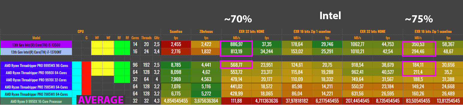

Heya @wendell @L1Sean Just did on old PC same test, maybe it is all about IMC?
and for some intel CPUs in compare

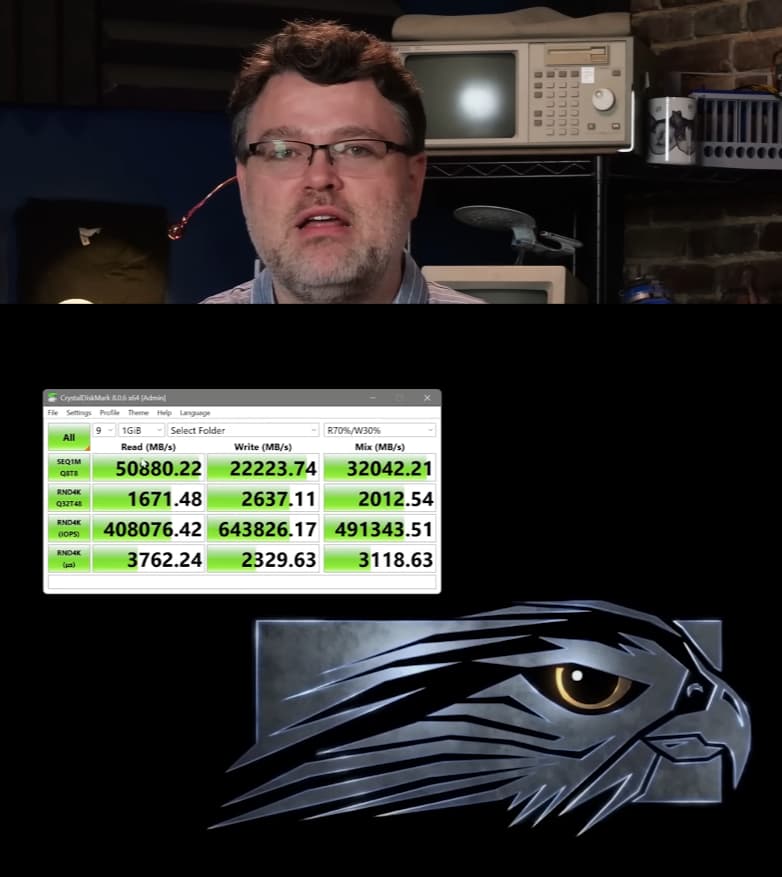

@wendell @L1Sean just rewatch Falcon Northwest review again I mean about that one :smiley: Thaaats speed for test in Nuke at least,not sure if it make any sense in Hou, but who knows :smiley: , sorry for so much activity, I am just planning build new PC :smiley: and wish I could get some I/O about :smiley: Cheers!
