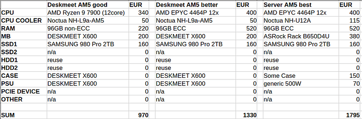

Some options are crystalizing:

As much you seem to want to hype the Deskmate there’s no confirmed (to my knowledge) support for ECC except that it boots (according to ASRock). There are severe limitations when it comes to overall connectivity and storage expansion.
The AM5 Epyc series are not confirmed as compatible with the Deskmeet and why bother with a new cooler for the 7900? The supplied one will do just fine unless there are physical limitations (haven’t checked).
I would also go for Crucial (P5 Plus or better/newer) instead of Samsung given their overall trackrecord.
