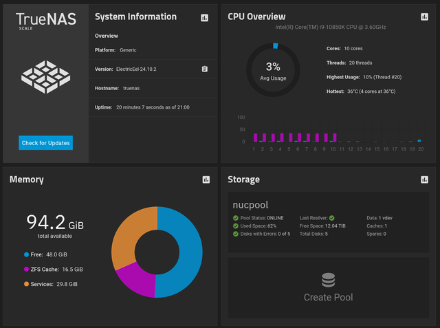

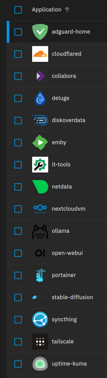

Truenas Scale:
Ubuntu 24.04 VM (TrueNAS) running - Crafty Controller, Kali Linux container.
Windows 11 VM (TrueNAS).

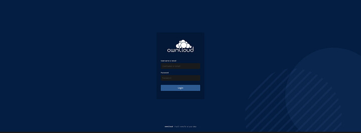

Just got Owncloud up. I’ve been pretty lazy on doing actual work on my Homelab here lately despite unironically just dropping like $1k on a new rack and accessories.

So this isn’t my first time trying to load OwnCloud in my HomeLab. Last time I was trying to use a host-mounted volume. This time I just created a podman volume as they do in their official docker compose file. But I just remembered why I was trying to do it the other way earlier. My HomeLab already has the files that I want to be accessible from OwnCloud in the syncthing user’s home directory. So I was going to use the same tactic I used with Jellyfin when I bind mounted my NFS shares into the Movies directory in the Jellyfin user’s home directory. So, although it works, it doesn’t work how I would like for it to work. The host-mounted volume didn’t work on rootless podman because the OwnCloud devs assume you’re using the rootful Docker daemon. So they have this asinine entrypoint that goes and chowns all the data directories, so this conflicts with the Linux host’s user namespaces: How to debug issues with volumes mounted on rootless containers
