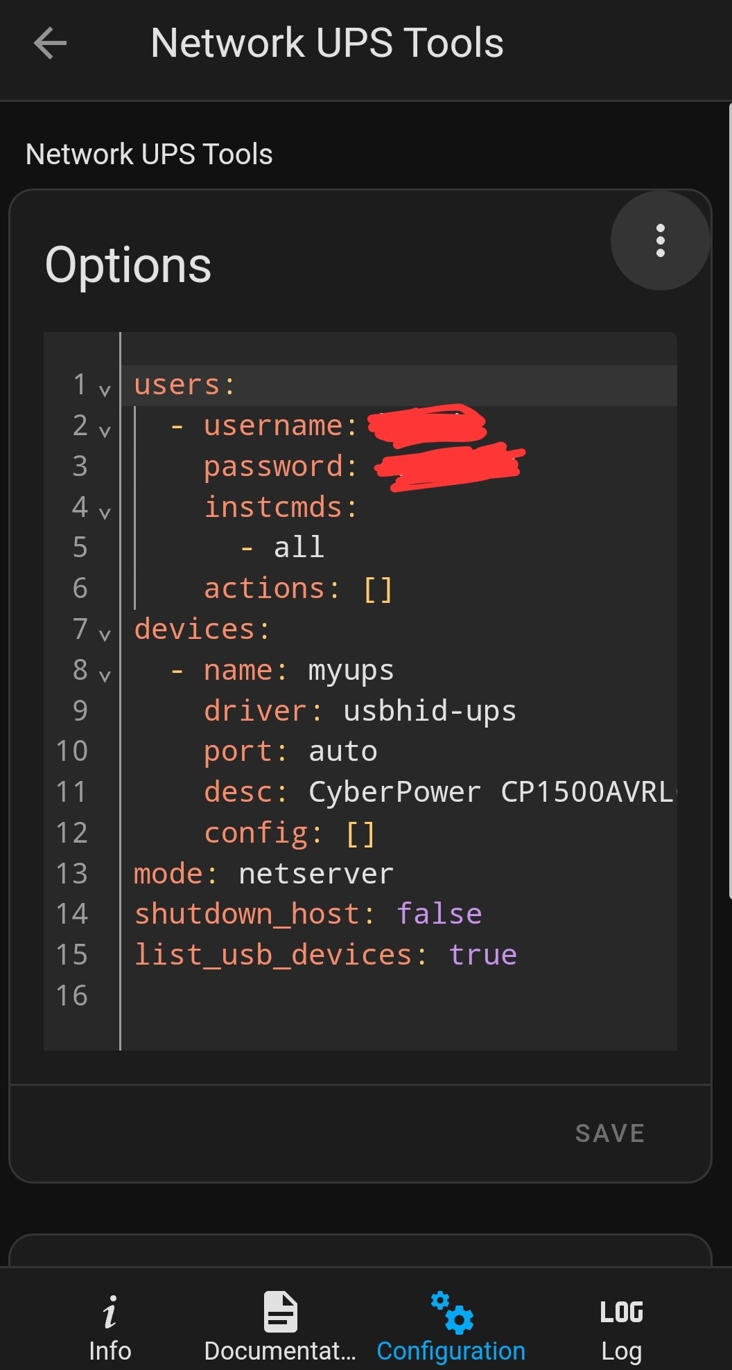

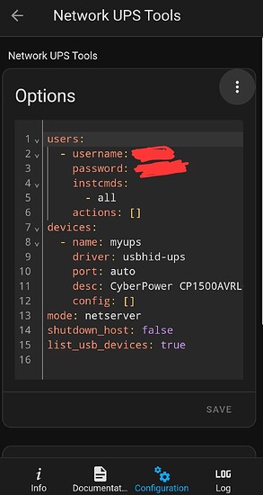

Progress so far: Deployed the NUT addon in HA on a Raspberry Pi. Connected the pi to a CP1500AVRLCD and using the following config
There are no nice tools available like “nutscanner -U” to get the driver and device info. Had to google my UPS for the info and yolo it. Add your own username and password for nut-clients. I tried not adding a user name and password and the add-on boot loops.
Unfortunately, the NUT add-on in server mode DOES NOT open port 3493 on the pi, so the only way to use it is through a nut-client within HA itself. Furthermore, HA will not automatically detect the NUT server for integration. You have to add the integration manually.

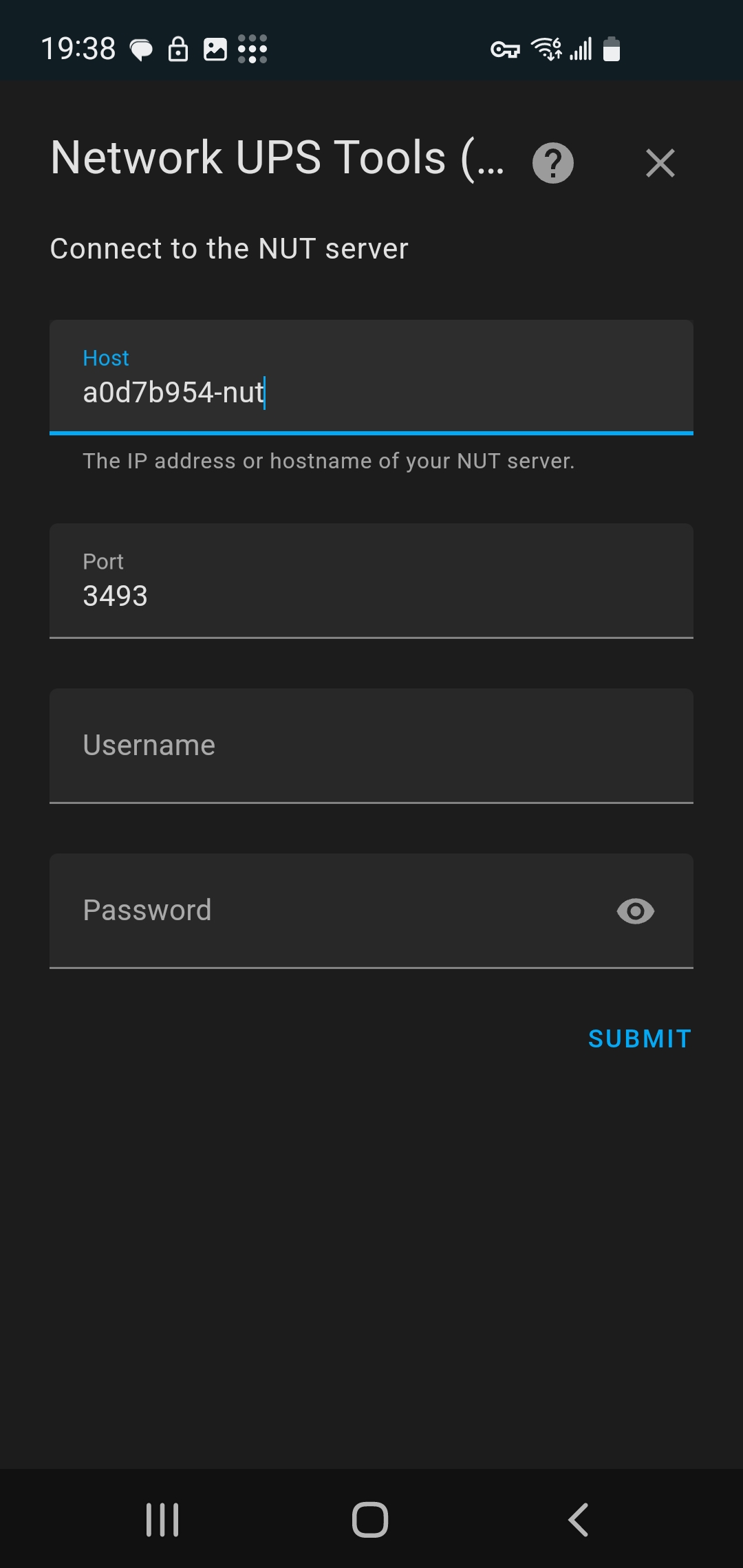

From the HA phone app, go to Settings, Devices and services, Add Integration. Search for Network UPS Tools (NUT).
To connect to the local NUT server, localhost will not work, you have to use a0d7b954-nut. I am not kidding.

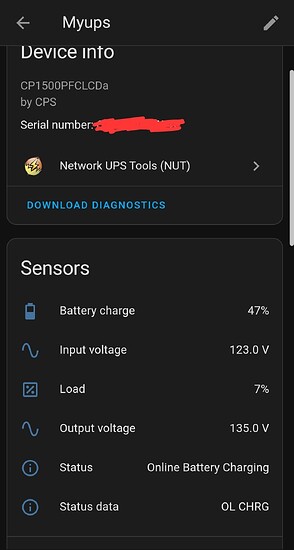

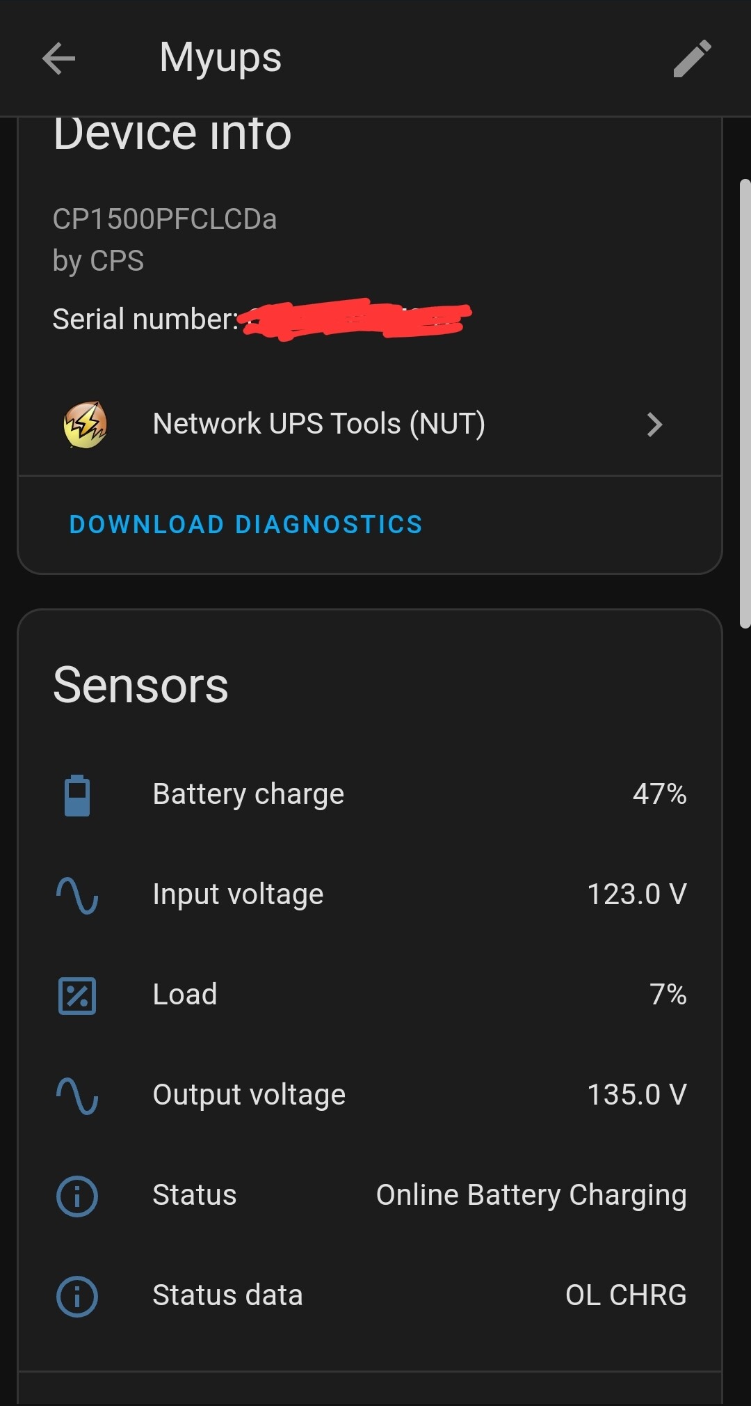

Enter the user name and password configured in the NUT add-on. It should connect HA to the local NUT server and default to 60s refresh. Once working, the result looks something like this:
