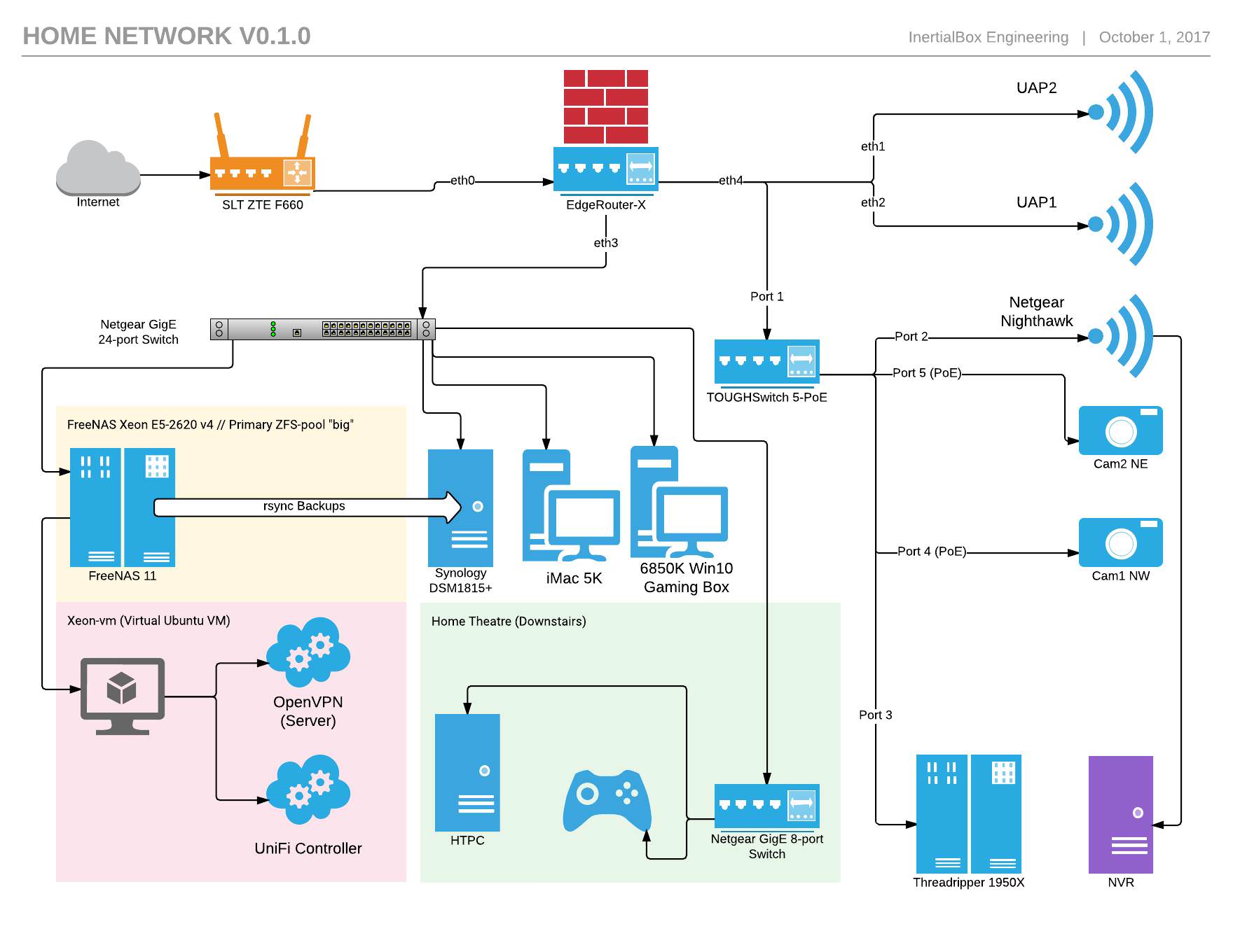

Thought I’d share the state of my current home-network
Lots of changes are on the way with the existing Threadripper being turned into a level 1 hyper-visor based virtualisation solution (XenServer, proxmox, will decide post testing). Adding a second Threadripper 1950X workstation too (see video for info)
Everything is primarily managed via the EdgeRouter-X - however, I plan to drop a pfSense router between en3 of the ER-X and the 24-port GigE Netgear Switch. That part of the network will have Suricata running for IDS/IPS.

Once the entire ‘rewamp’ is done, I’ll detail it in a dedicated build-log.
