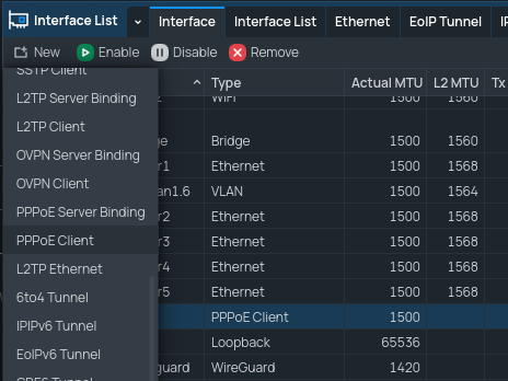

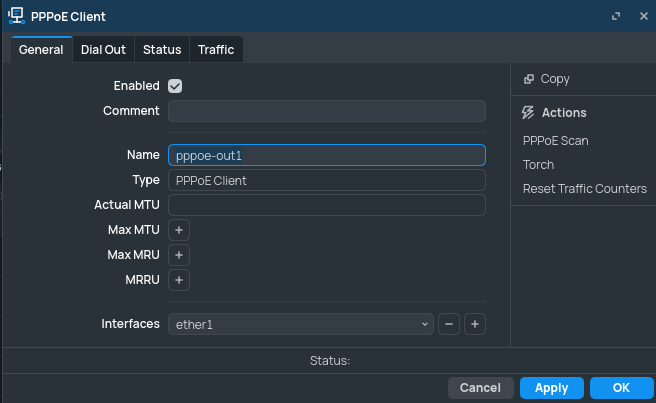

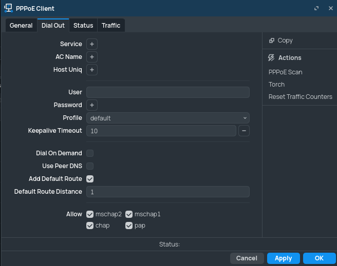

I can help you with 1, because I had to set that up for my own ISP router replacement! The others… Pointing along the way for a bit, but you’ll have to do some reading and testing for those.
Using WinBox, you go to “interfaces” and look at the tab “Interface”, there you can add a new interface. You add a PPPoE client by clickign “New” and selecting “PPoE Client”:
Once there, you get a new window where you can give the general info in the “general” tab on your PPPoE interface, like giving it a recognisable name and specifying general things like the MTU and such.
Don’t forget to connect it to the interface you have your WAN connection plugged in, which tends to be “ether1”.
And in the “Dial Out” tab, you fill in any user and/or password info you need to connect to your ISPs network.
Then you click “Apply” or “OK” and it should switch over!
That should be enough to set up a connection to your ISP…

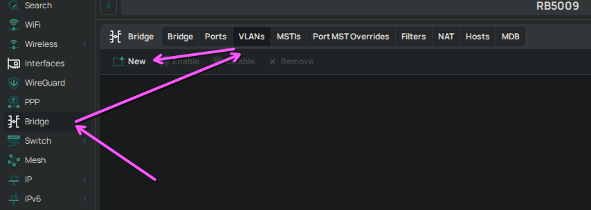

When you have those set up, head over to the VLAN section of the docs… There you get some examples about how to set it up as well. I might need some tinkering, depending on how you want to configure it, but I’d advise you to keep the connection where you connect to the router free of settings changes while you’re tinkering. If all is right on one interface, you can always add others when it works.

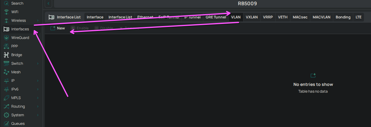

Then either the device on eth5 is vlan-aware, or it goes into a different vlan.
Having had a long think about this, I would set up 3 VLANs:
10 - trusted - ether2,ether3
20 - inet_only - ether4
30 - town_square - ether5
https://wiki.mikrotik.com/Manual:Interface/Bridge#VLAN_Example_#3_(InterVLAN_Routing_by_Bridge)
If you prefer “clicky button”, then:
and:
By default, Mikrotik routes between all networks, you have to then firewall them to taste.

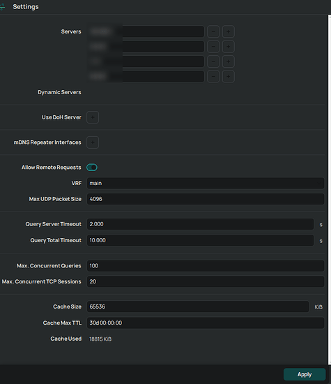

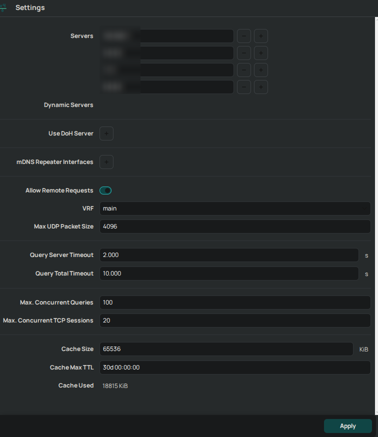

That is a tad strange.
My config for reference:
Cache used is quite high because I have been playing around with the Adlist function.
There are a few scripts that add DNS-entries for each DHCP-lease generated.
