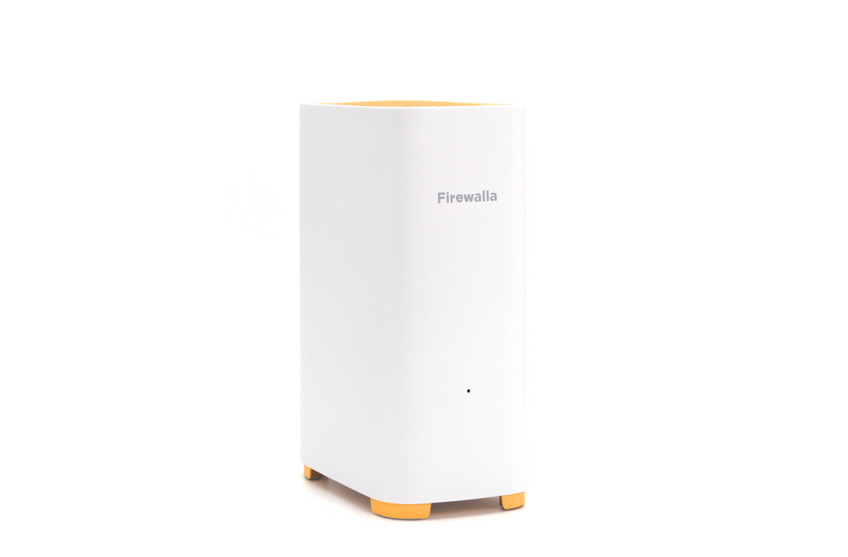

Firewalla if you want a fully home focused product with advanced security, but super simple options and interface and dont mind shelling out the money to have the majority “just handled for you”.

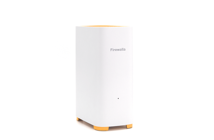

But if to look at this beauty, Firewalla Gold Plus: 2.5G Cyber Security Firewall & Router Protecting | Firewalla, what would I need to have a wireless network? A separate module, which connects through ethernet? (meaning that if I have 3 devices, connected through ethernet, I would be using that last port for wifi, right?)

If you want all of the automatic security features like the zero trust stuff then you would use the Gold Plus router and their AP7 wireless access point:

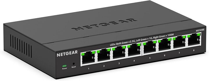

You can plug that right into the Gold Plus or you can use a network switch if you want more wired devices, such as this one:
