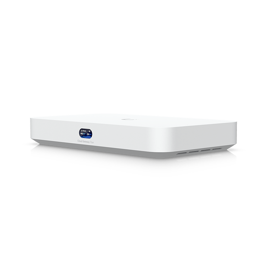

Cloud Gateway Fiber ($280) will do 10gb with firewall rules and various features enabled, but only 5gbps with traffic inspection turned on. Hardware controller required but is built in to this router so no extra cost.
Route10 and Cloud Gateway Fiber are more GUI based and less of the “more complicated” options. The Route10 does have a CLI though and a way to make CLI changes survive reboots. Cloud Gateway Fiber does not really have a CLI, but does have more GUI options than Route10 and actually now has just about every routing type option you would want.

Most of the equipment ordered has come in. I have the new ap and router installed and working. I Don’t know if I have all the setting set correctly as there is a lot of setting I’m not use to setting. Any suggestions / tips?

Not sure I’m getting the full 2gb connection from my isp to my network. the speed test on the router says yes and the speed test on my pc says no. the lan connection is thru an sfp+ port and the wan connection is thru a rj45 port. not sure if this makes a difference.

Figured out the slow speeds. turns out I needed to plug the cable from the wan into the sfp+ port and plug the lan cable into 1 of the 2.5 gb ports to get the correct speeds apparently. Will get a dac for going from the new router to the switch and then see how fast I learn getting that up and running.
