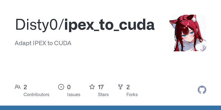

Side note if you have a intel gpu and Nvidia gpu in the same computer you may have some problems. Intel used some hijack code I helped make to get models to use intel cards when they are making cuda calls. You dont need it to run ai playground (its in there) but if your interested in how, here is this.
