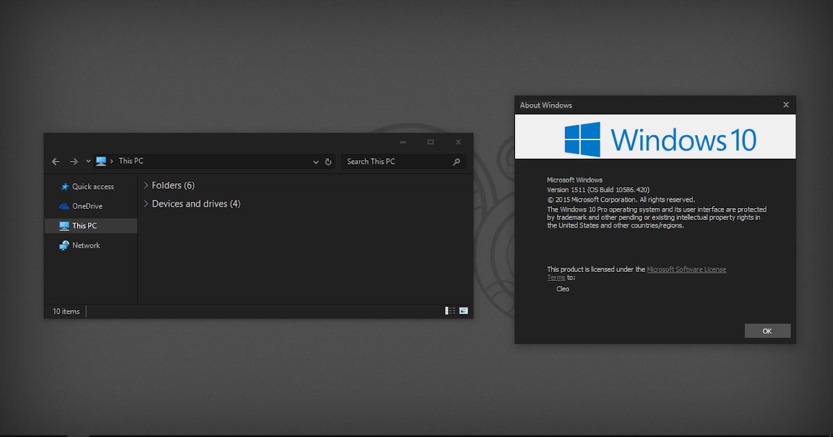

So basically. I wanted to add a theme to windows, messed around with 3 files and now my PC turns off after the "blue windows logo", I can get into BIOS, and I made recoveries of before I did anything, but it won't let me F8 into the safe mode. So I'm not really sure what to do. If you need any more info, photos or a video stc. Feel free to ask, and I'll gladly post them, but if anyone knows anything to help it sure would be appreciated.

So this is the method I used, I did everything exactly as it said, so I think it was the part about renaming the original file and replacing it, the "themeui.dll.del"
