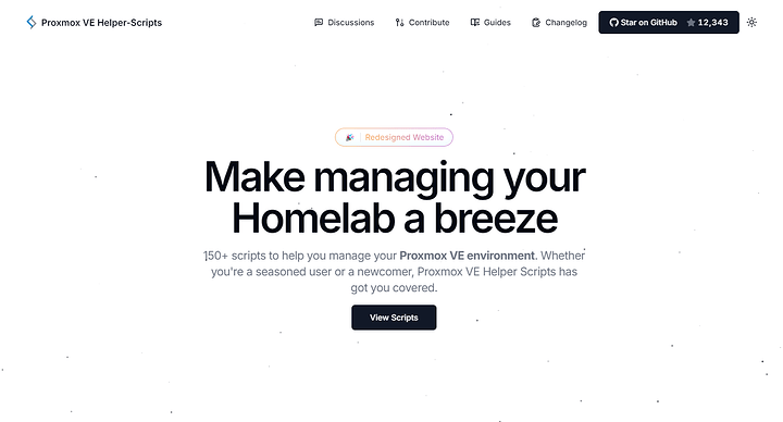

Also if you’re unfamiliar with Proxmox look at this:
They got tons of scripts to setup vms and lxc containers.
