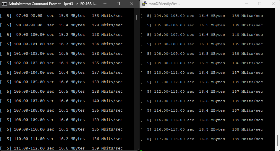

My internet connection is 100mbps down and 40mbps up.
I installed iperf3 on my router through docker and run test with the Powerline and I get around 140mbps which is more than enough for my internet speed
