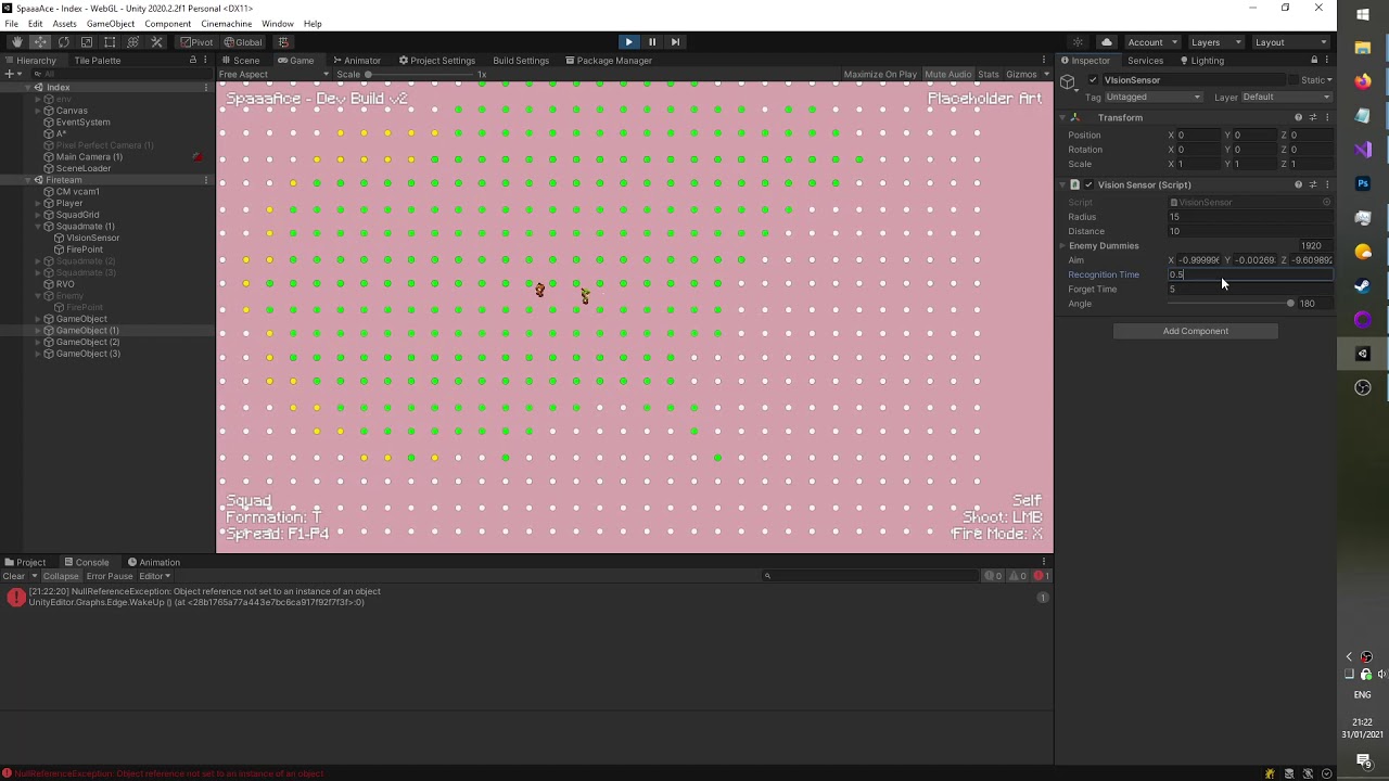

Right now the next thing I want to prototype is of course some enemies and then some teamates since I judge those to be crucial for the exploration gameloop. To build some “AI” (or more accurately an “expert system”) I first have to know how the world works. How far down I can abstract it so traverse it.
Unity for example has a tile system they added recently with which you can create tile sets and then brush IDs instead of having to place “objects” manually. Since I’ve not used it before, I have to check out if you can mix different tile sizes or, if it’s one per grid or one per layer… or if I may even want to not use that system altogether.
If all the little sprite tiles are the same size I’m working on a grid. And what is a grid if not a graph… and you know what that means: A* for traversing that graph.
If I want something dynamic that can adjusts to a changing and chaotic environment could use some sort of sensory approach using 2d raycasts, and some weighted steering. That would also take care of the “perfect path” problem (where you calculate a path and it becomes invalid half way through the actor following it)
Since I’m probably gonna go with A* on this here’s a little obstacle avoidance code:

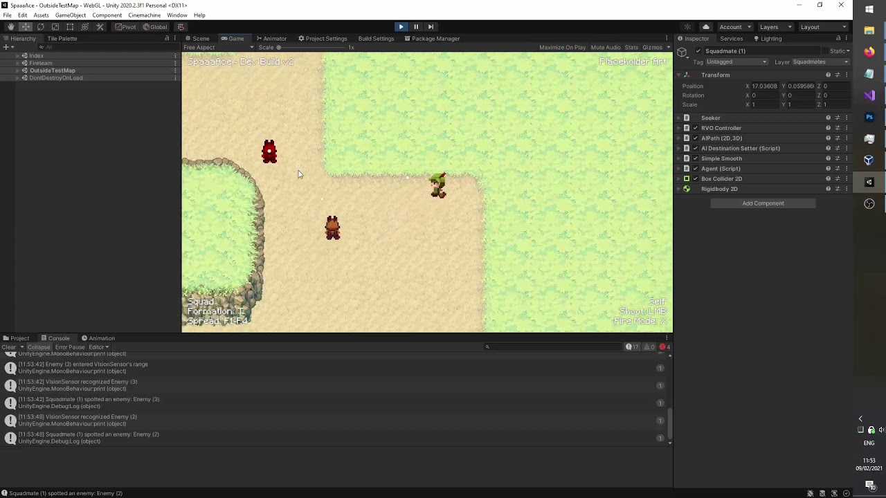

Captions Log 28.11.2021: The natives are getting restless, a few already eyeing me for my supple meat. I should move on soon.
Captions Log 29.11.2021: The Tilemap approach really is MUCH nicer to author and quite a bit more performant, just as the ancient texts foretold. I must learn the language of the A* again and converse with the spirits to guide my minions on their path to destruction.

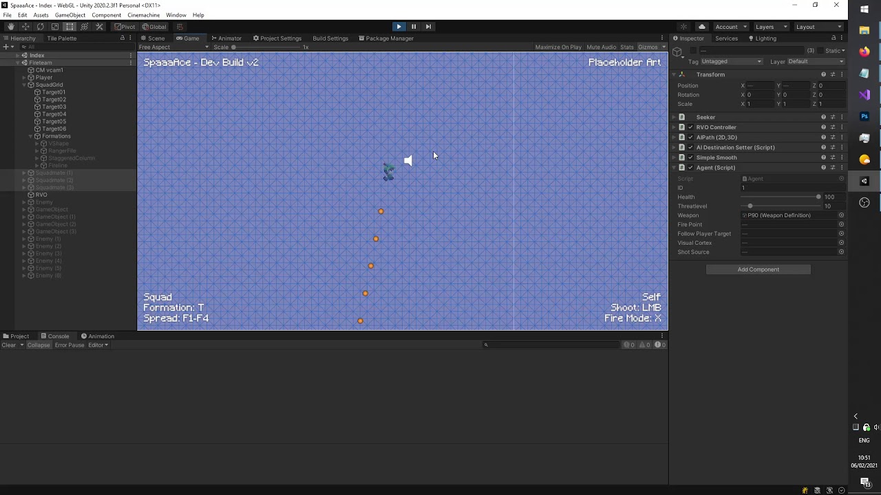

Today I started learning about fire-team tactics, formations and bumping/bounding. It’s interesting and oh boy is it gonna be a challenge for me to build it.
First I’m gonna try to make a staggered column layout work… with a player that can just randomly change directions… so i gotta squish the grid around the player with the possible positions on it’s direction over time while moving or something like that.
This would be so much easier if I just got rid of one person and did a basic v formation like you get in mass effect or something.
edit: turns out it is a wee bit important if the guy i’m controlling is left or right handed but since they are set characters I am in luck and can simple declare the protagonist right handed.
now I just have to decide if I want to have a dynamic positioning or if a specific person/role will take a certain spot in the formation
edit2: seems to be working :slight_smile:
I’ve got a new thing to test: Pathfinding, Squadmates and Walking in formation: http://tourable.de/spaaaace/v2/
The little white dots are their desired positions, the placeholder graphics are the mates. They can avoid static obstacles, dynamic obstacles and eachother.

edit2: I needed a quick win so I added the ability to switch between different formations and change the team spread. honestly that’s amazing, i can’t believe I didn’t add that sooner.
so now you can do stuff like a standard patrol formation
sticking close and in line if you gotta go through difficult terrain
spreading out and using each teammate’s sensors to find something you might be searching for
Alright, I think I’ve build a pretty okay little vision system now.
Each frame it checks what’s in range, then it filters out everything outside a 60° cone. If remembers the things it has seen before and not (yet) lost track off. Once something has been seen long enough it is recognized and the agent can do stuff with it. If a recognized object hasn’t been seen for a while it’s forgotten. If a seen but not yet recognized object breaks line of sight it’s forgotten. The speed at which an object is recognized scales with distance from view direction.
  IEnumerator Detect()
    var previousTime = Time.time;
    var previousPos = Vector3.zero;
    var seenThisFrame = new Dictionary<Collider2D, float>();
    while (true)
      var currentTime = Time.time;
      var deltaTime = currentTime - previousTime;
      var currentPos = transform.position;
      var velocity = (currentPos - previousPos).normalized;
      if (velocity.sqrMagnitude > 0.01f)
        _aim = velocity;
      seenThisFrame.Clear();
      var range = Physics2D.CircleCastAll(transform.position, Radius, _aim, Distance);
      // detection
      foreach (var hit in range)
        var collider = hit.collider;
        var group = collider.GetComponent<GroupID>();
        if (!group)
          continue;
        var dir = (hit.transform.position - transform.position).normalized;
        var angle = Mathf.Abs(Vector3.Angle(_aim, dir));
        var l = 1 - angle / 60f; // the higher the l value the faster the object is going to be recognized
        if (angle < 60)
          seenThisFrame.Add(collider, l);
      // recognition
      foreach (var item in seenThisFrame)
        var collider = item.Key;
        if (!seenObjects.ContainsKey(collider)) // we just spotted something
          seenObjects.Add(collider, 0);
        else // here's something we've seen before
          seenObjects[collider] += deltaTime * item.Value;
          // we've seen something for long enough to recognize it
          if (seenObjects[collider] >= RecognitionTime)
            recognizedObjects.Add(collider, currentTime);
        // update the last time I've seen a recognized object so i can forget it later
        if (recognizedObjects.ContainsKey(item.Key))
          recognizedObjects[item.Key] = currentTime;
      // forget the ones we didn't see this frame or already know off
      for (int i = seenObjects.Count - 1; i >= 0; i--)
        var collider = seenObjects.ElementAt(i).Key;
        if (!seenThisFrame.ContainsKey(collider) || recognizedObjects.ContainsKey(collider))
          seenObjects.Remove(collider);
      // slowly forget recognized objects we havent seen for a while
      for (int i = recognizedObjects.Count - 1; i >= 0; i--)
        var item = recognizedObjects.ElementAt(i);
        if (item.Value < Time.time - ForgetTime)
          recognizedObjects.Remove(collider);
      previousTime = currentTime;
      previousPos = currentPos;
      yield return null;

Originally I set out to add occlusion testing to my old vision sensor aaaand now I rewrote the way the ai perceives and recognizes the world. I had a really nice and fancy system there but for my type of game it didn’t really work out too well.
The new sensor is quite a bit simpler but works by the same principle: It sees something, after a while of seeing something without breaking line of sight(change blindness) it recognizes it and fires an event.
What’s changed is that I’m not doing spherecasts anymore to see what’s in range, that’s done by using a collider, next I check if the thing is on screen using the built in orthographic frustum culling on the sprite renderers. Turns out it’s annoying to have eagle eyed companions that go off and snipe enemies way before the player can even get a hint of their existence. For the finale I’m shooting a ray from the sensor to the target and make sure there’s nothing in the way.
The results are 360° vision for anything unobstructed, on screen in a circular range, which I think fits this type of game much better and is on par with the way the player experiences the world. Whereas before a squaddie could stand right next to an enemy and not see it if it was facing the wrong way. A side-benefit is some much cleaner and more maintainable code.
[RequireComponent(typeof(Collider2D))]
public class VisionSensorV2 : MonoBehaviour
  private Dictionary<Collider2D, float> _seenObjects;
  private Dictionary<Collider2D, float> _recognizedObjects;
  public LayerMask LayerMask;
  public float RecognitionTime = 2.5f;
  public float ForgetTime = 120;
  private void Awake()
    _seenObjects = new Dictionary<Collider2D, float>();
    _recognizedObjects = new Dictionary<Collider2D, float>();
  private bool IsVisible(Collider2D collider)
    var renderer = collider.GetComponent<Renderer>();
    if (!renderer)
      renderer = GetComponentInChildren<Renderer>();
    // make sure it's on screen
    if (!renderer || !renderer.isVisible)
      return false;
    // check if we can see it
    var dir = collider.transform.position - transform.position;
    var hit = Physics2D.Raycast(transform.position, dir, dir.magnitude + 1, LayerMask); // maybe instead cast for all, discount anything attached to this same body and then check for obstructions
    //print(string.Format("target: {0} hit: {1}", collider.name, hit.collider ? hit.collider.name : "undefined"));
    return (hit.collider == collider);
  private void OnTriggerEnter2D(Collider2D collider)
    print(collider.name + " entered " + name + "'s range");
    // we already recognized this one, no need for another round
    if (_recognizedObjects.ContainsKey(collider))
      return;
    // never seen this thing, let's start recognizing it
    if (!_seenObjects.ContainsKey(collider))
      _seenObjects.Add(collider, 0);
  private void FixedUpdate()
    for (int i = 0; i < _seenObjects.Count; i++)
      var item = _seenObjects.ElementAt(i);
      if (!IsVisible(item.Key))
        continue;
      _seenObjects[item.Key] += Time.deltaTime;
      // we've started at it long enough to recognize it
      if (item.Value >= RecognitionTime)
        print(name + " recognized " + item.Key.name);
        _recognizedObjects.Add(item.Key, Time.time);
        // TODO: fire off an event each time we recognize something new so the agents can sub to it and set their FSMs to react
    // now that we know what it is we don't need to analyze it further
    foreach (var item in _recognizedObjects)
      if (_seenObjects.ContainsKey(item.Key))
        _seenObjects.Remove(item.Key);
  private void OnTriggerExit2D(Collider2D collider)
    // line of sight was broken during recognition of the object, failed to recognize what it was.. fun fact works for humans irl too
    if (_seenObjects.ContainsKey(collider))
      _seenObjects.Remove(collider);
I’ve got some ideas to modulate recognition time based on alertness and distance but that’s a story for another day.
