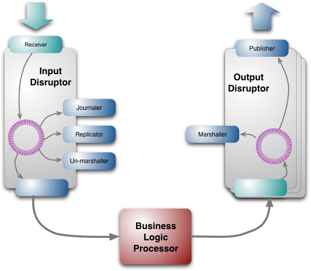

https://lmax-exchange.github.io/disruptor/
https://docs.oracle.com/cd/B28359_01/server.111/b28310/onlineredo001.htm#ADMIN11304
And here is example of optimizations category some developers must know and use, otherwise half of internet would be pissed (random link):
