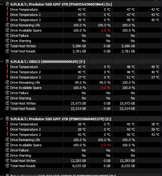

Check system event log. Run some SMART diagnostic program. I’m not sure which one works for Windows though. The drives keep a record of detected problems like weird controller shutdowns or when the controller had to stop because of heat.
You can for example show the metrics to an LLM and it might give you an idea of whats happening.

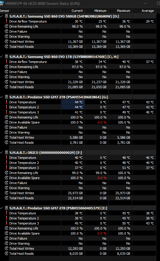

this is what temps look like on hwinfo

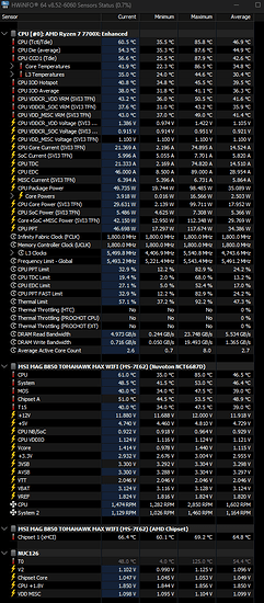

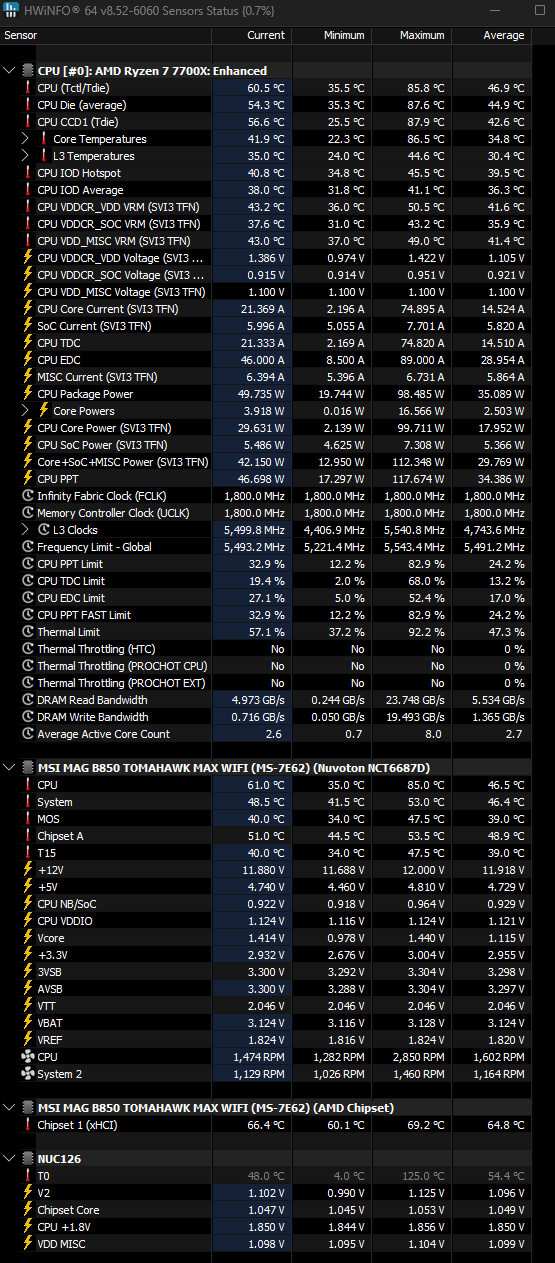

If you look in hwmon, keep an eye on the board power consumption, see if there’s anything bouncing up n down..
i’m not too sure where to look at here
M.2’s use 3.3v rail, your 3.3v rail gets as low as 2.6v, that stands out to me but I’m by no means a psu expert so I have no idea if thats too low, but it stands to reason a power draw spike with a substantial Vdroop sounds like the root of your issue
