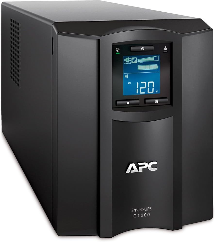

Not sure what UPSs you buy, but all of mine do this. I only use APC.
EDIT: 5 second google, shows a consumer grade UPS that does it.
Maybe I wasn't precise with my words. I didn't mean to say that there aren't any consumer VFI UPSs. What I meant was that most consumer UPSs aren't VFI, since that is usually not necessary and introduces cost that isn't necessary. Most consumer UPSs (that I have seen) are VFD ones, which simply switch between passing the input to the output (maybe through some filters on the way) and the battery + inverter.
Btw: I had an APC BackUPS before I got a VFI UPS which did pass the 9kHz on to my devices.

The one you linked seems to be a VI UPS (line interactive) that is boosting the input voltage if it dips and limits it, if it gets too high. What it can't compensate for however are frequency issues since it has to output the same frequency as there is on the input. If the frequency on the input is usually stable, then you are fine, but if you want the extra protection against unwanted frequencies and other disturbances like I experienced, you need a VFI (online) UPS or a "normal" UPS with a separate line conditioner, but that might be more expensive in combination.
The one I have is the "BlueWalker PowerWalker VFI 1000T/E LCD". It can run in bypass (standby) mode and in VFI mode, which I am using.
