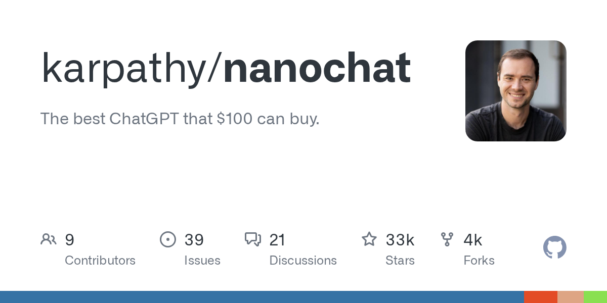

Has anyone tried building nanochat?
Building now with a single RTX Pro 6000. It looks like it will take me about 38 hours. I didn’t see a thread about it, so wondering if folks were aware of the project. I had issues mixing my Blackwell and Ada GPUS, but I also want to try clustered mode with torchrun and see how that goes!
Andrej Kaparthy talks about it here:
