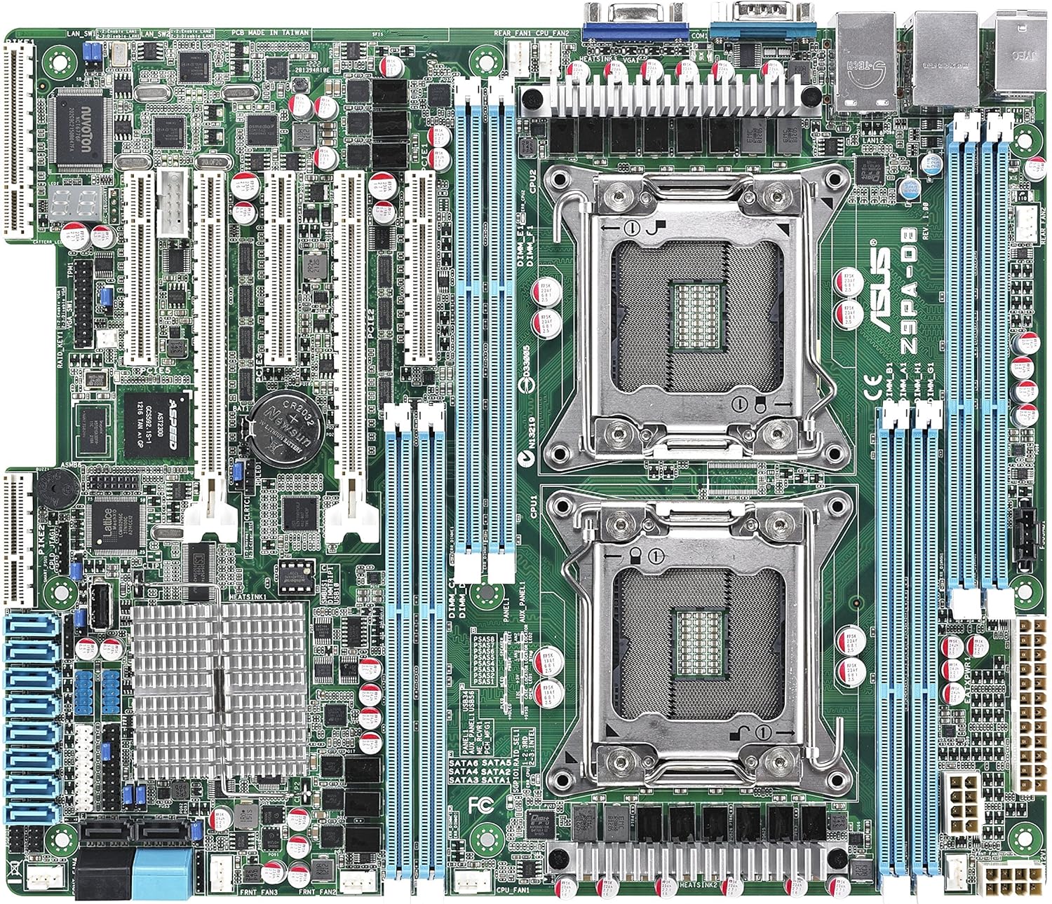

So it looks like I am gonna pick up some xeon 2670's on ebay and then I think I will go for this motherboard.
Was looking at ebay and not a whole lot of options of different prices. But it is ATX, so just an ATX case should be fine. thinking of also getting 4x8GB DDR3 RAM to make up the 32GB can always throw in another 32GB later if needed.
Need to find some quiet coolers for the chips and a good PSU now. Any suggestions on things to change?
