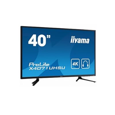

Could you share what monitor you are using and give you opinion on it?
The only ones I can find are:
Looks like a great choice at first, but many users are reporting burn in while using it for productivity uses.
MVA panel causes high response time and overall image quality is not that great
EDIT: sry for the german amazon links
