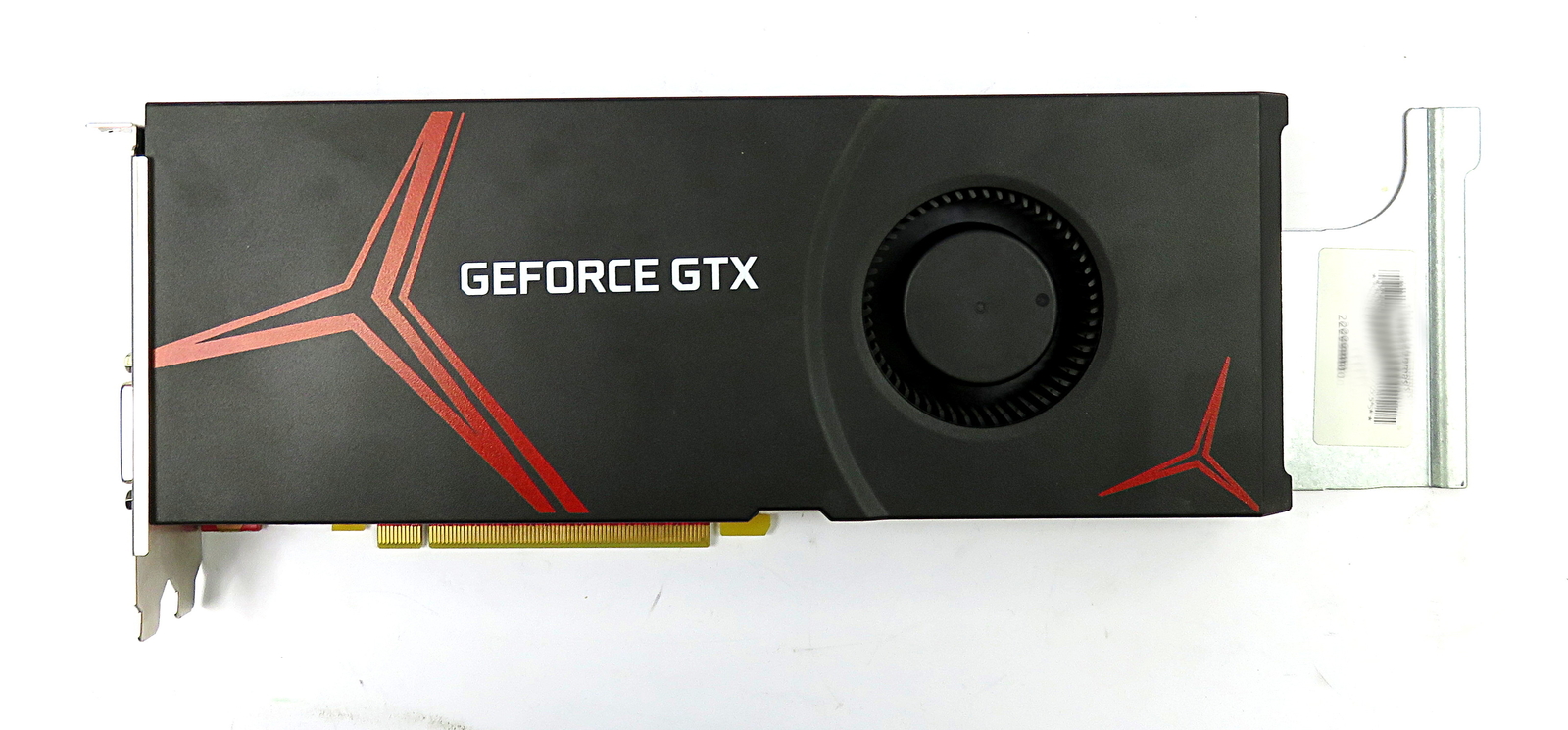

and one of the card
specs of the card here: Lenovo, rebranded MSI GTX 1070, a few qestions
