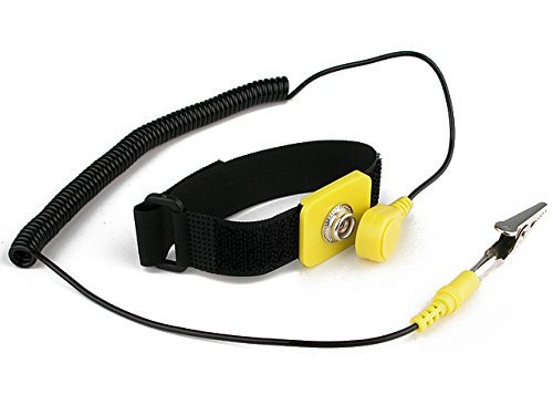

So as the title says, I'm about to build my very first gaming rig. But I'm scared as f*** to damage expensive components like the mobo or GPU. I know all the ways of grounding myself, but the problem is that my socket doesnt have a ground (old house). So it wouldn't matter if I plug in my PSY and have an anti-statis wristband attached to it right? What are good ways of grounding myself without using the ground in my socket? PLS, help!

Oh I didn't read that. Still, touching a metal part of the case should be fine. I've had my hands in hundreds of PC's and I"ve never had an issue, if OP is that paranoid get one of these.

all those bands do is discharge the static electricity that gets built up by your body. As long as they are connected to metal they work the same as touching the metal on a power supply or touching a door knob on your way out of the house. As long as that static is discharged you are fine. Which computer components these days are almost; I say ALMOST protected again static shock. As long as you don't touch the fingers on Video cards, Memory, or any additional item you are fine. Try holding the MB on the edges and don't put your paws all over the board.
