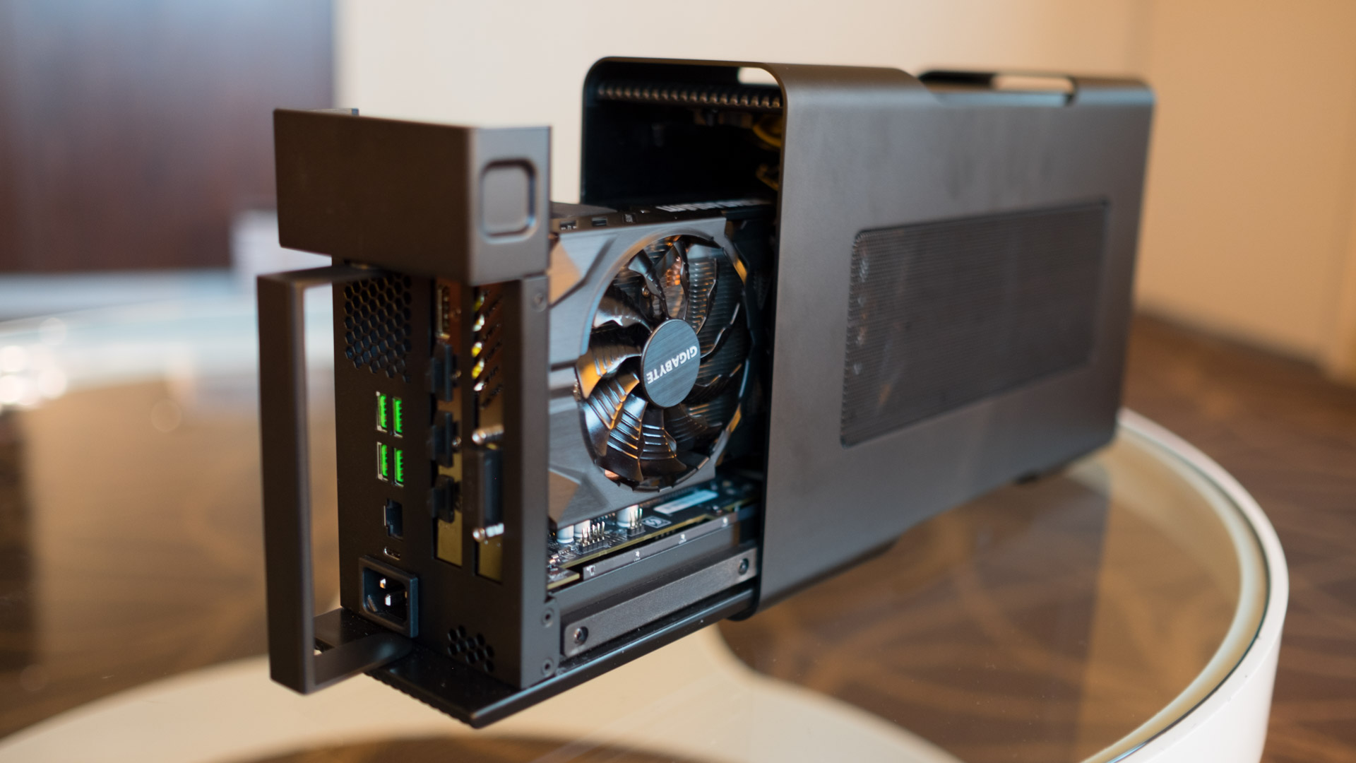

There are enclosures as well
Yeah but those cost more than the diy solution and require thunderbolt 3
