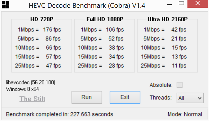

BTW this is the H265 decode benchmark results for a Core2Quad Q8300, which is VERY similar in design and performance to the Q8200 owned by OP (the q8200 being the equivalent from one year prior, and ~94% the raw performance).
For reference twitch (which is still h264, so less quality for a given bit-rate) recommends (and will downscale too when not set to source) only 3.0-3.5Mbps@1080p (so a similar quality h265 would decode on OP’s Q8200 at 60fps), 1.8-2.5Mbps@720p (easily >60fps, probably over 100). Netflix supports both H264 and H265, but unless your on the very top quality option for H265 the advantage is only that using the H265 is it’s going to consume less bandwidth (averages like in the ballpark of 50% at 720p or 1080p), so if your internet bandwidth is a constraint and you watch lots of Netflix the 1030 is a solid upgrade over the r7 250, through if your also gaming locally the gtx1050ti still offers the same features. Sadly there is not a heap of other h265 content to consume right now, so unless you have something in mind that needs it, I’d personalty wait, it could be easily be another GPU generation before h265 becomes common in mainstream content. Although even if a big provider like YouTube did switch tomorrow, you could still run its current content playback bit-rates through h265 on the Q8200 via software decoding (and they will likely lower bitrates used anyway), so unless you have a higher resolution (1440p or 4k) TV the current setup going to be fine for most content.
