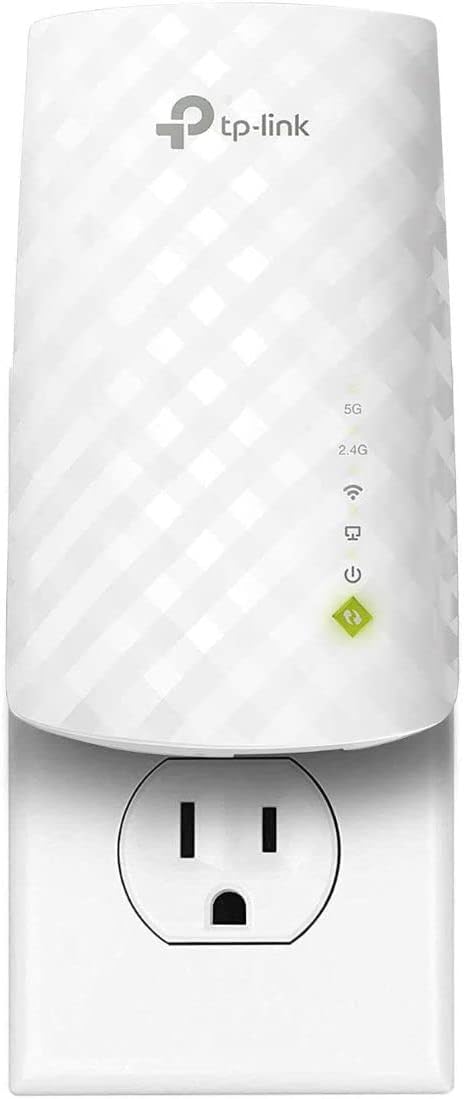

Wireless “range extenders” all suck. Convenient to use, but network performance will take a nosedive. You can mitigate the losses a bit by using dual/tri/quad band repeaters/extenders. I have such a setup in part of my house and it works decently. TP-Link extenders are decent.

@vicbyrd thanks, i’ll look into those units, my only problem with them is I assume they are intended to be plugged in so that the antenna are pointing upwards of sorts. My grandfather, who built this house and everything on the property by hand, decided it was a brilliant idea to install every single power outlet on this property with the ground plug up. sigh Not sure how that would effect the signal.
If you can run a cable you should run a cable. Even if you have to do it via moca to get a wired connection to the far spot.
That is actually the safer way to do it, and how it is required to be done in commercial locations in the US now.
