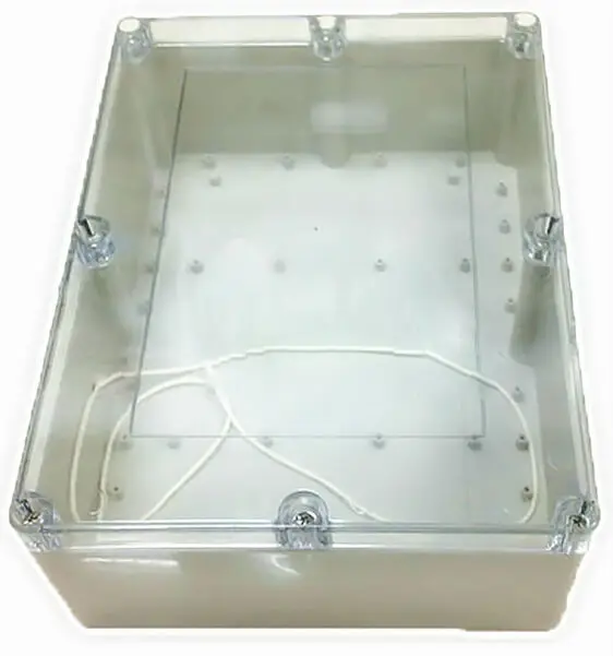

I'm unsure as to whether I should go full DIY and do the above with this and setup a pi with the RPi-Cam-Web-Interface in a weatherproof box (perhaps alike this) with a battery bank to act as a mini UPS, or if there's any better solutions for this kind of thing on the market.
