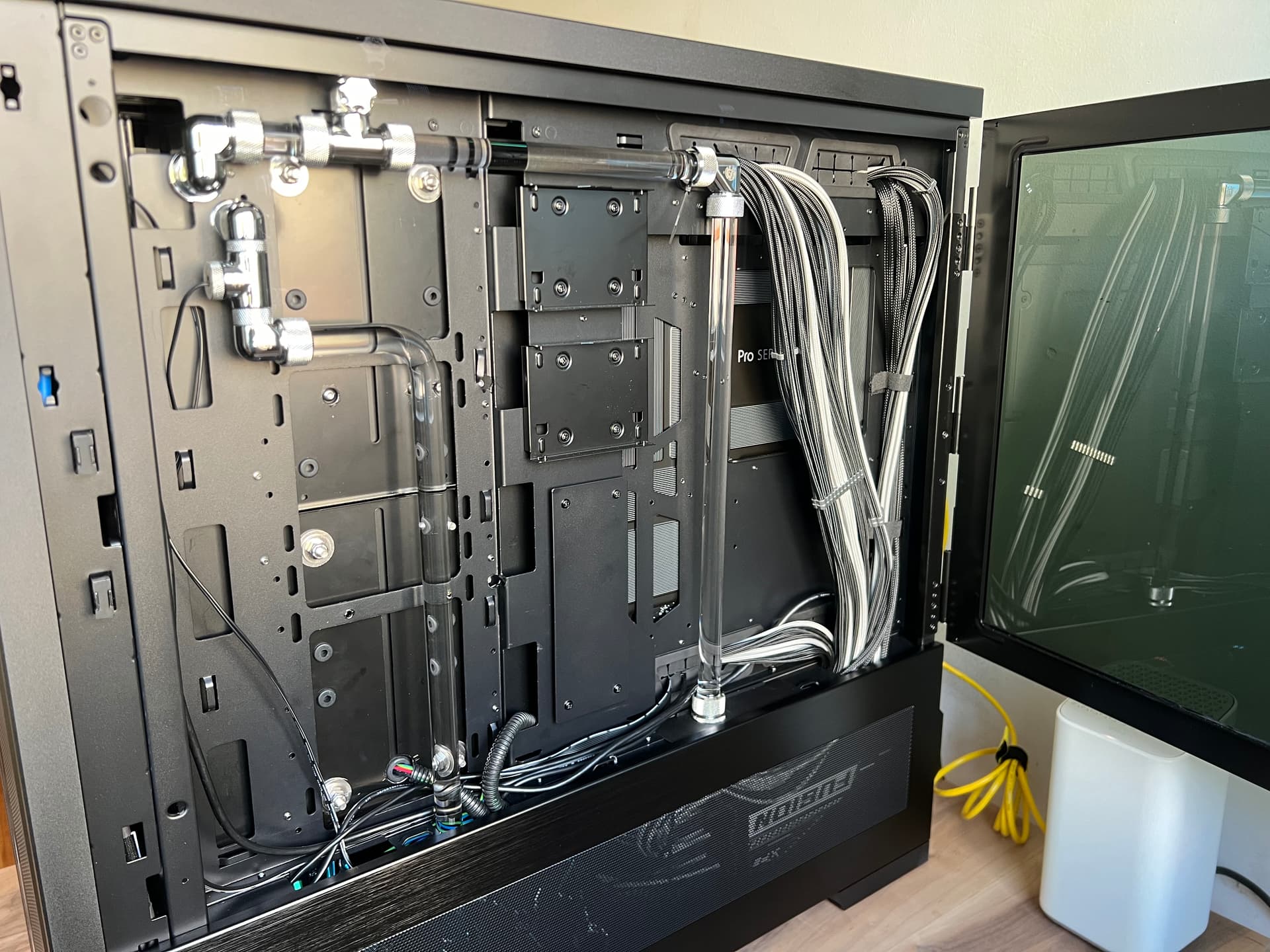

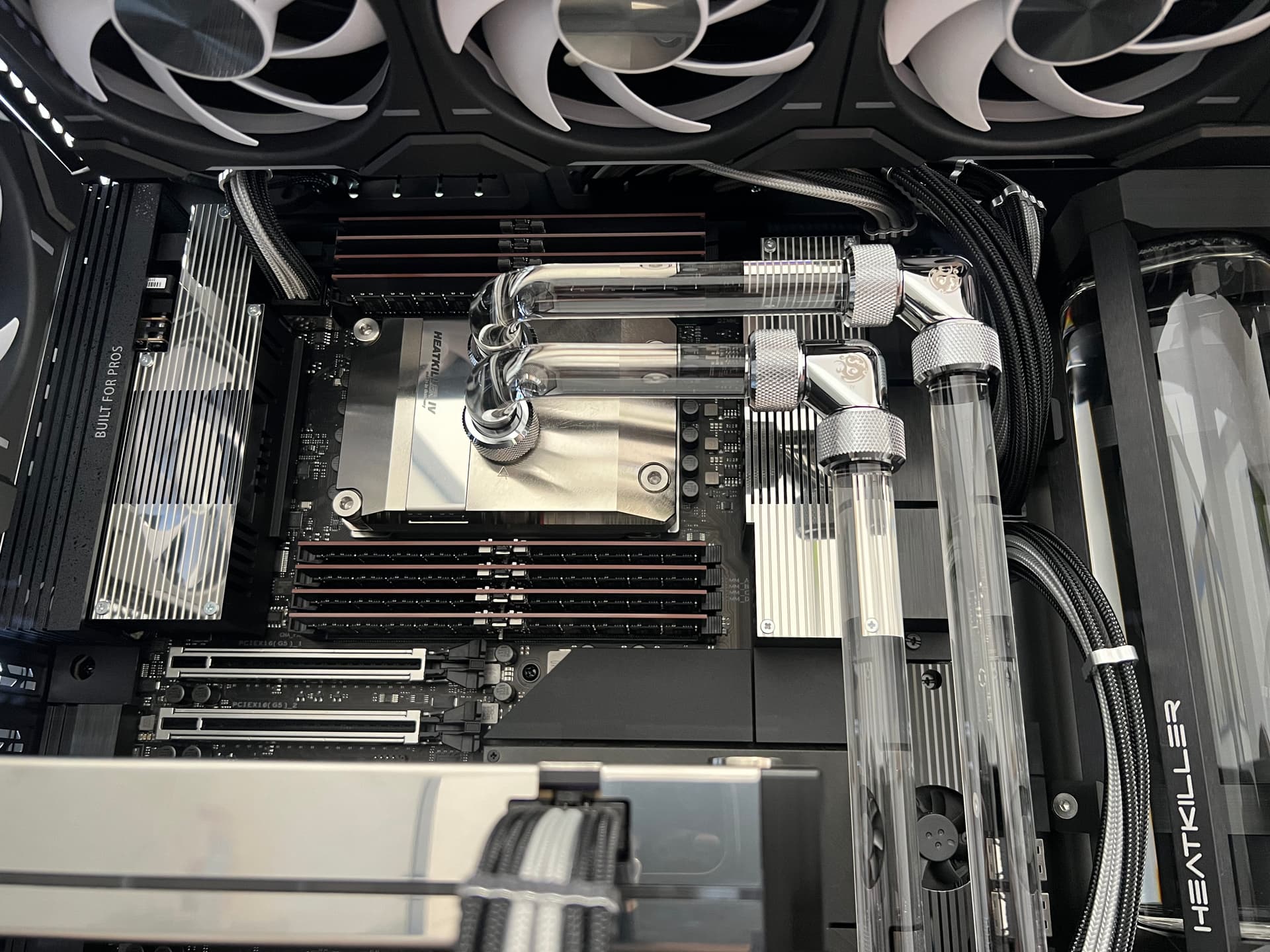

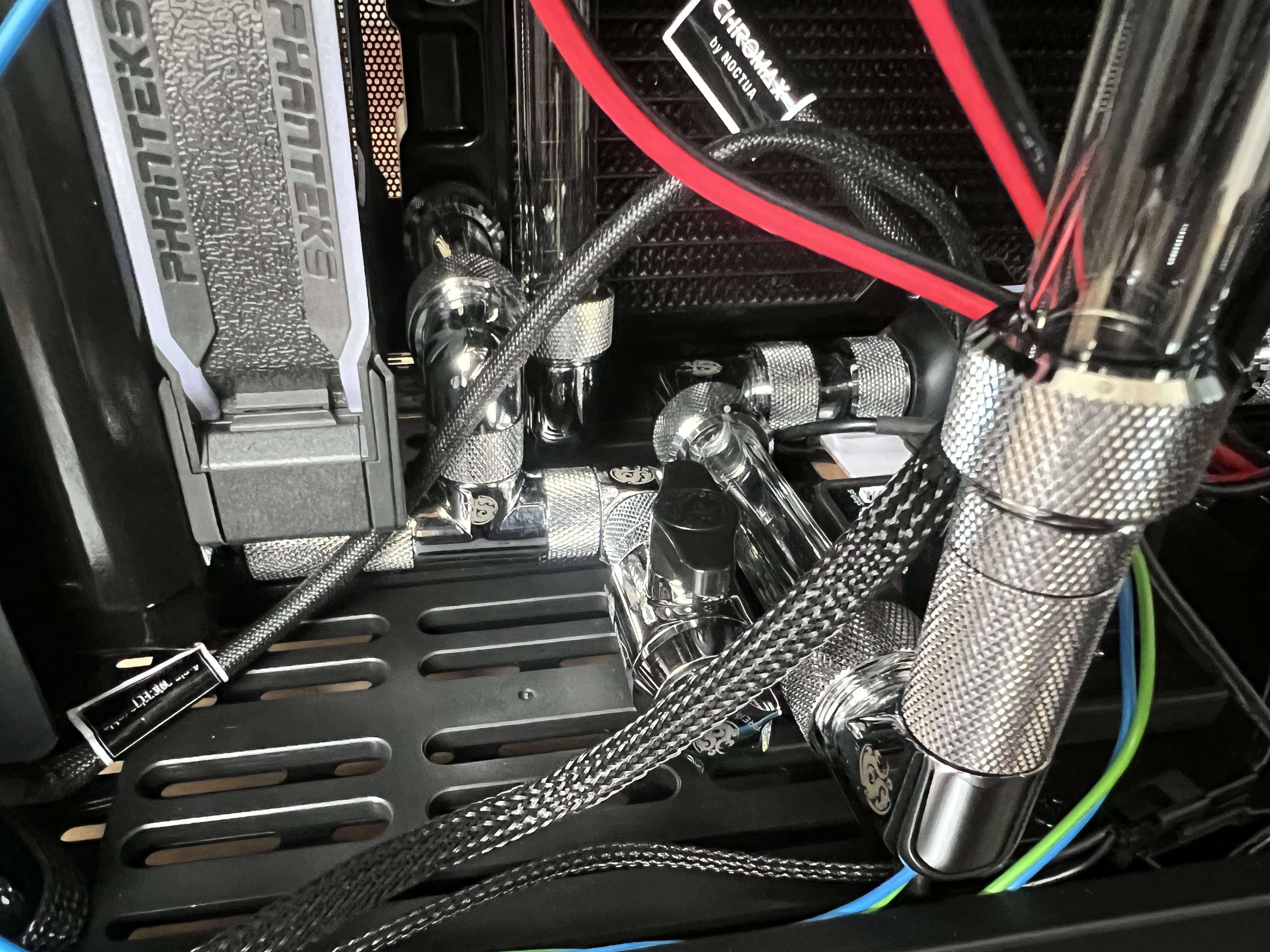

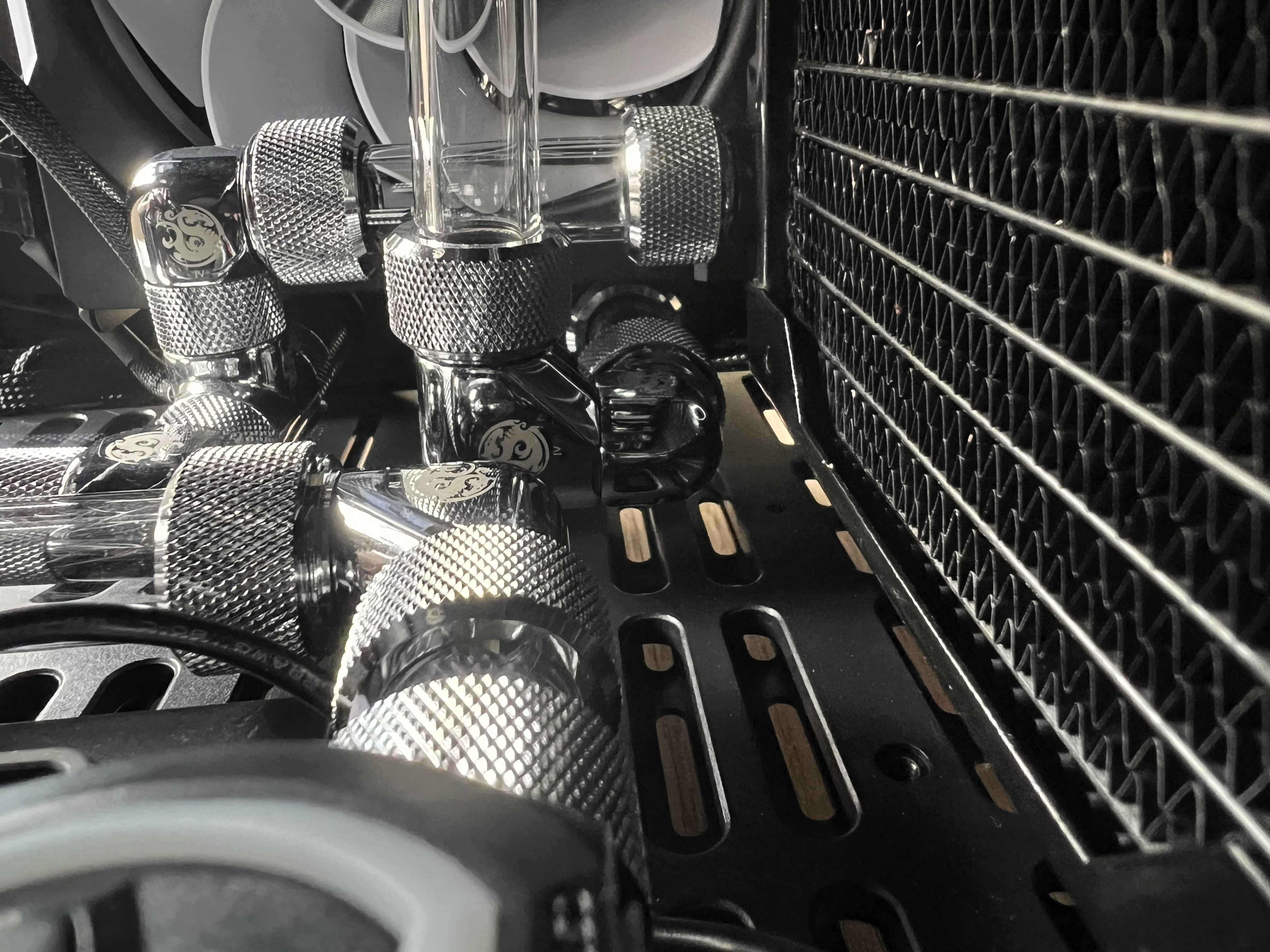

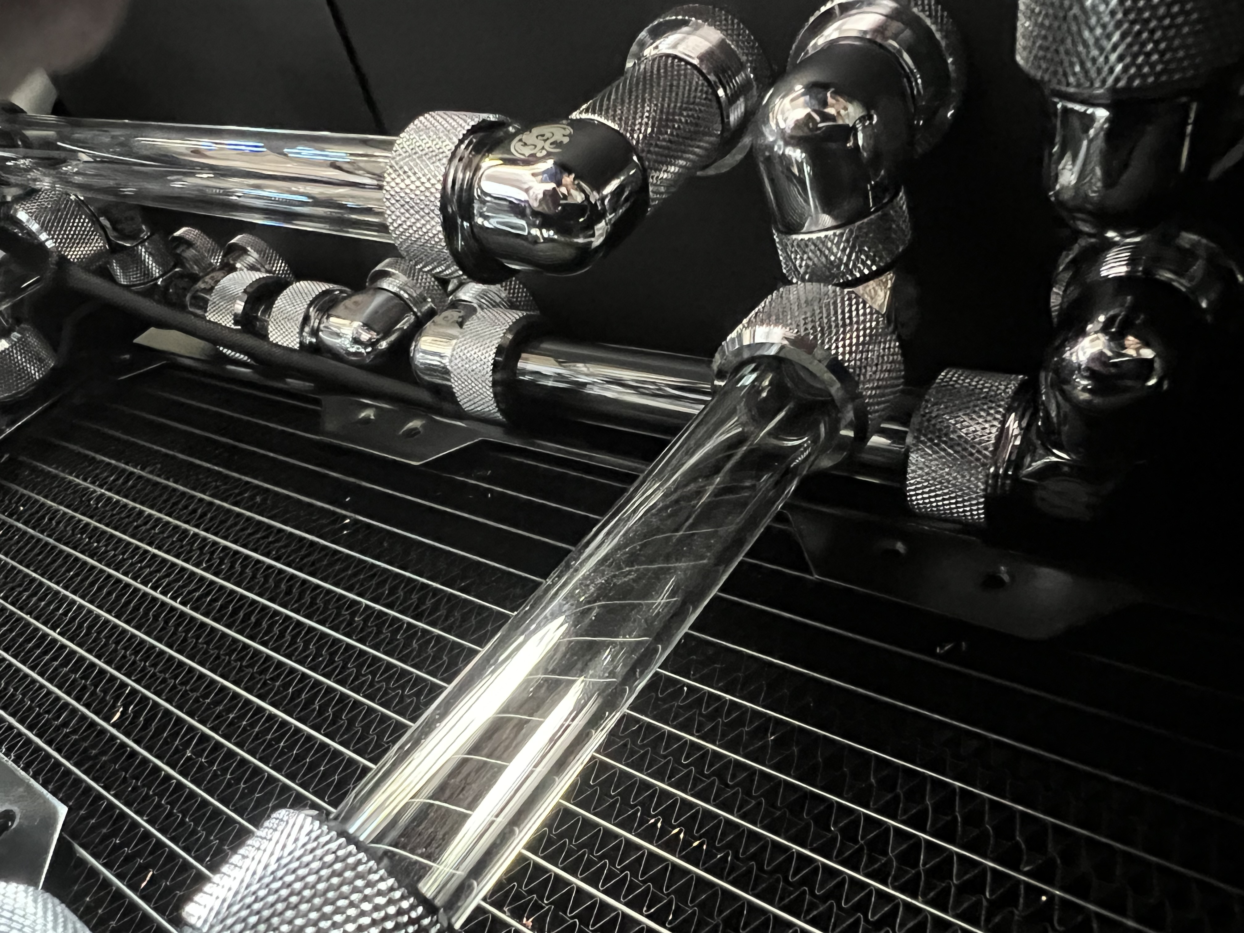

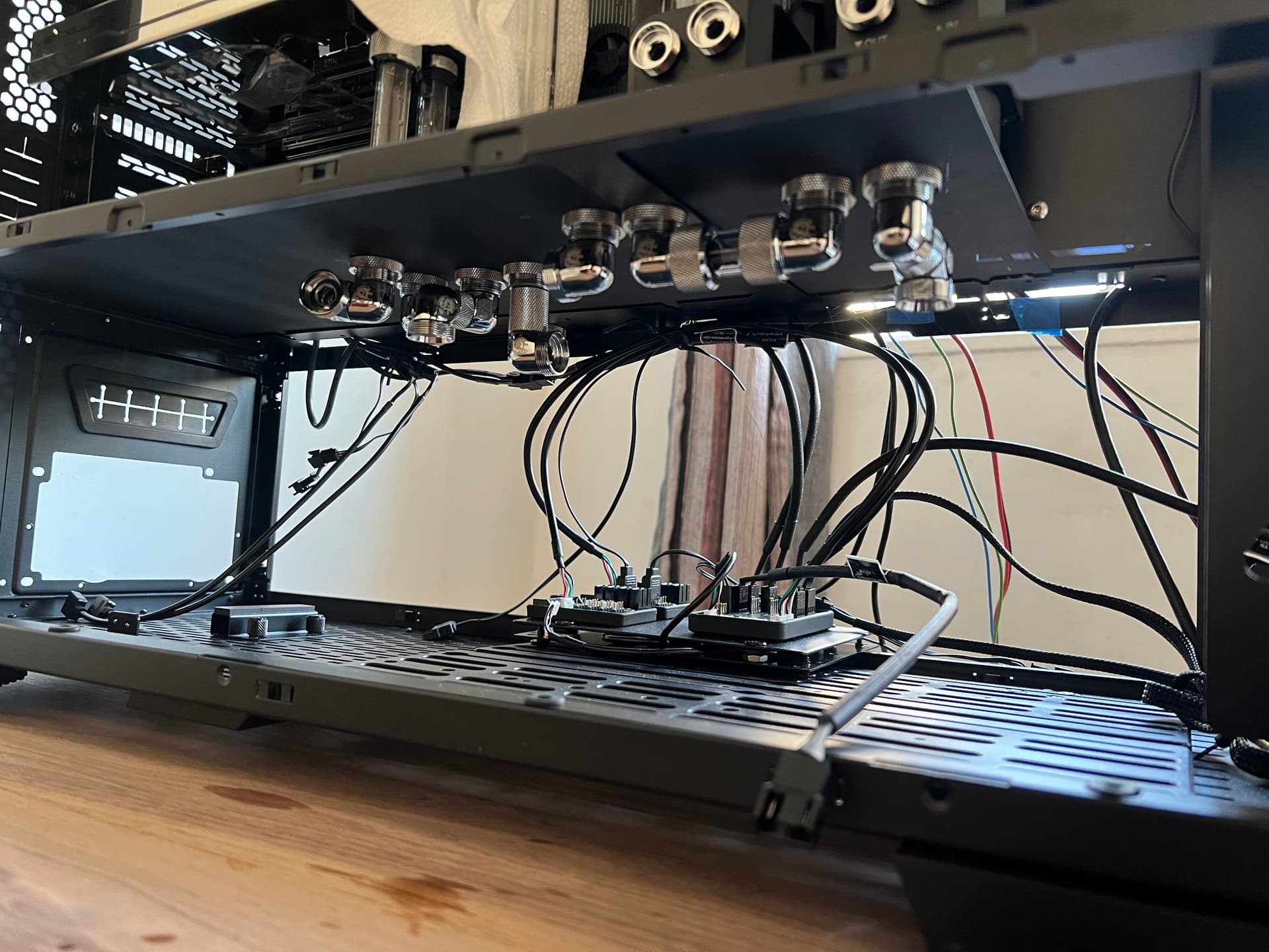

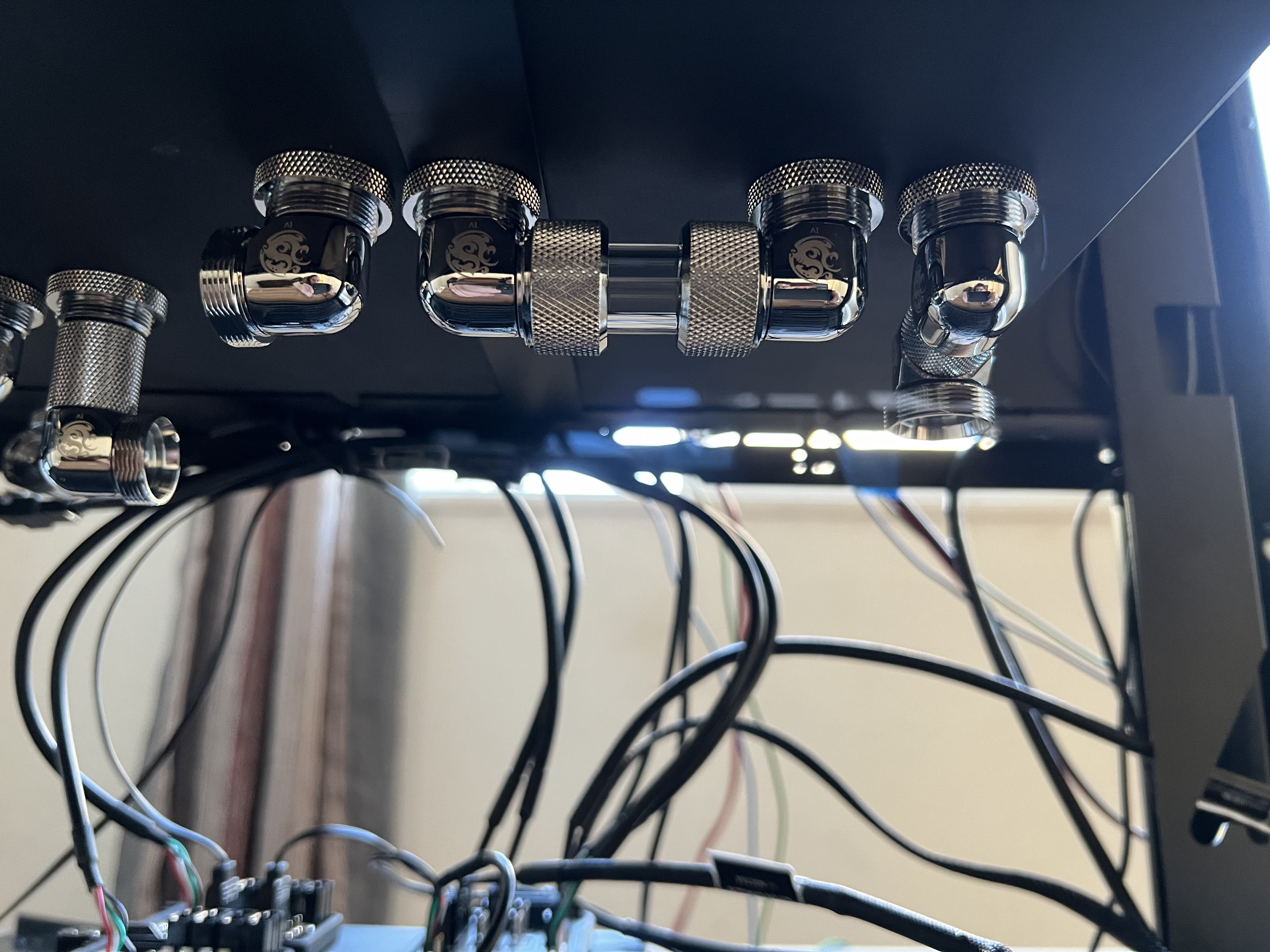

Thank you! It was quite the undertaking, glass tube had to be cut with a glass band saw because I needed such precision pieces for the very short pieces, took about 30 hours of sitting at the saw cutting little sections off to get them precise enough, and if you look closely between the motherboard and reservoirs you might be able to see that I was within about 3 mm of not being able to fit the mother and still plug in the 24 pin.
I used 16 gauge steel plate to make the reservoir mounting plate and the bottom plate which offers great support for the gpu
Here’s some more photos as well

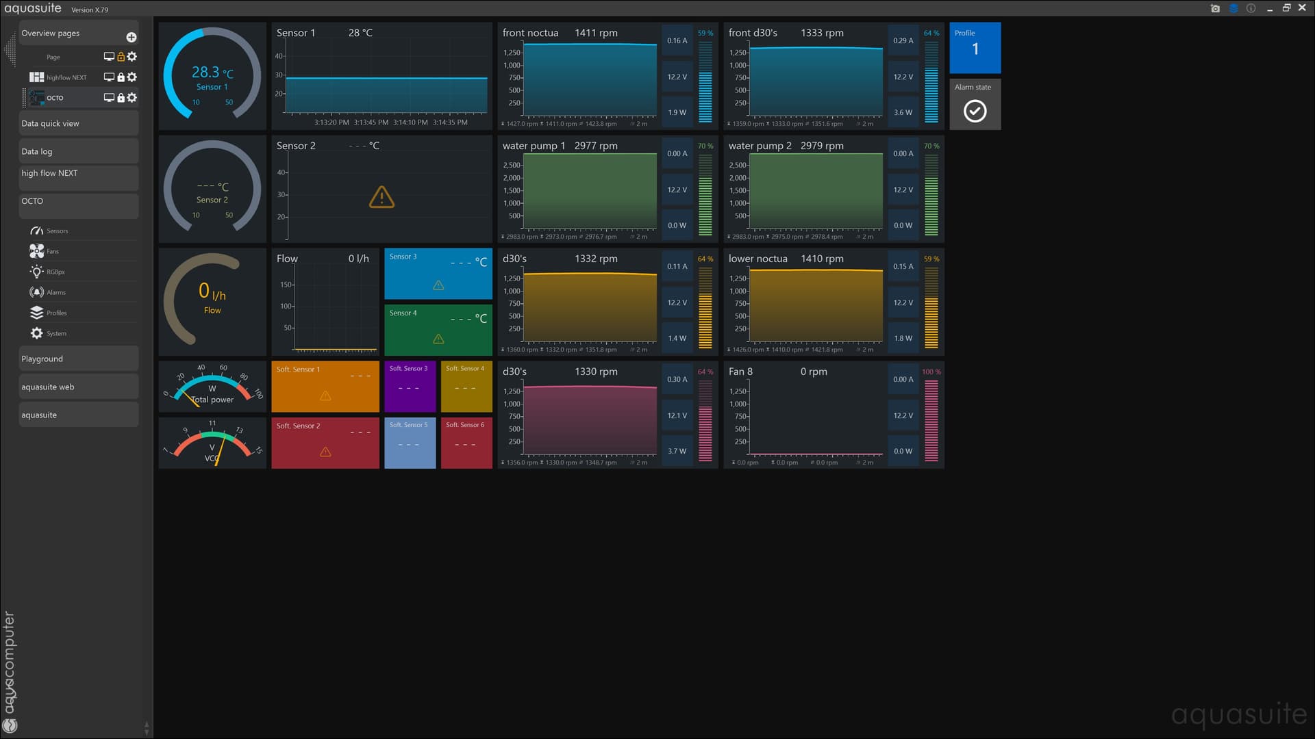

also with a system like threadripper being meant to be a very long-term system so anything that lowers Maintenance is important, I am using aquacomputer dp ultra clear coolant for that reason as well.
@twin_savage thank you and yes, the glass was the only choice for me for this system for a number of reasons, the ability to use hardline compression fittings was a must for a system this expensive glass also doesn’t deform at the ends of time and heat cycles, while soft tube bard fittings are probably more secure there is the evaporation/permeability issue as well as plasticizer leaching over time. I’m using aquacomputer dp ultra clear for coolant as well so should be maintenance free for the most part. i also have an aquacomputer highflow next which among other things has a coolant quality monitoring function.
As much as I don’t like using Aquasuite (I’m not a scientific mathematician, so I can’t find online nor know how to create a fan historesis ramp over time based on temperature) and the subscription that they constantly notify about just to upgrade the firmware on my OCTO, I also love it. I feel like the author of FanControl did the community as a whole a massive favour and simplified that particular function. There is a plugin(s) for aquacomputer hardware, but they don’t allow for control, only monitoring.
