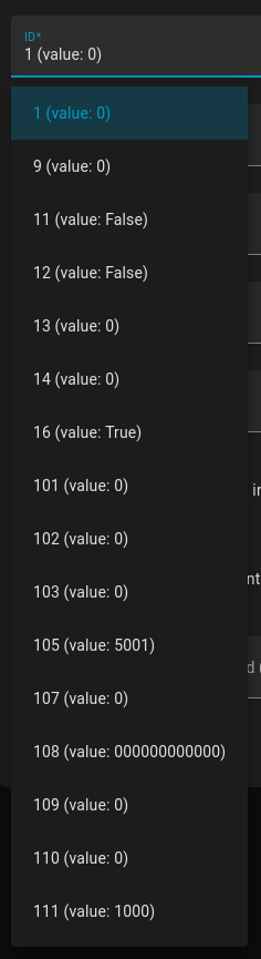

Long story short, I got the debug info off the LocalTuya integration, and I can definetly see the missing data there, it’s just it’s not in a format I can readily use. Apparently the LocalTuya integration expects numbered “DP” entities, whereas this thing is reporting them as named “DP” entities
Here’s a partial dump of LocalTuya’s debug json. Partial because I left some stuff that seem probably would dox myself :smile:

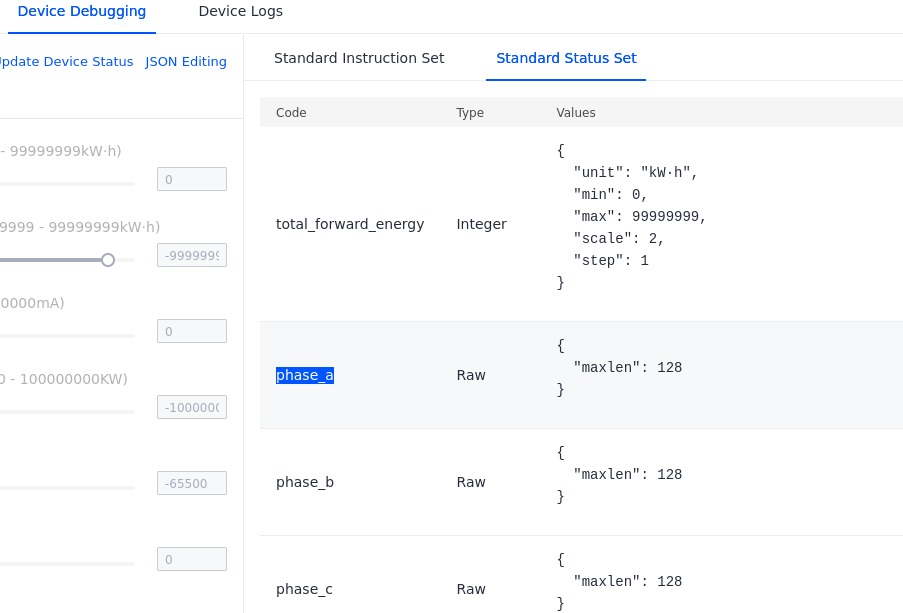

I just learned I can get the numbered ID’s in the most convoluted way, by using the developer tools in my browser to sniff at the network queries when I request a log for a specific entity.
One step ahead, two behind: I now know dp_6 is “phase_A” which is the wonky-formated “raw” voltage readout

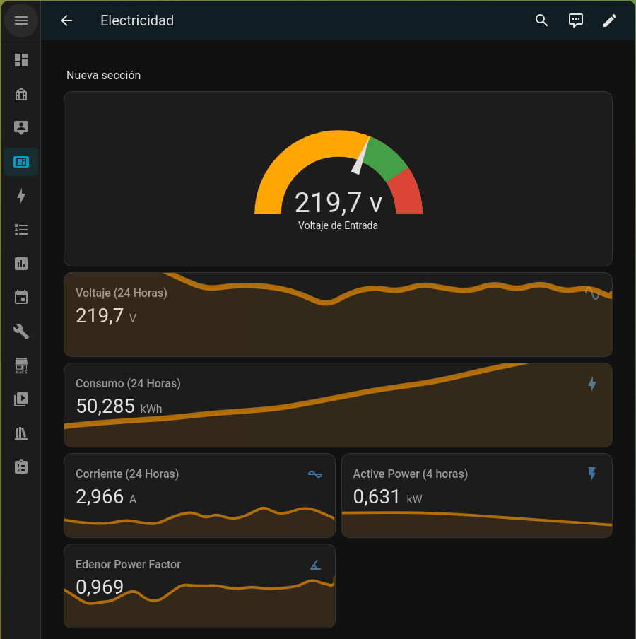

Anyway, I forgot to post back for future reference. I ended up using all of the LLMs available to me to decode the weird strings (which ended changing again when I installed it completely).
I still don’t get the hype around “vibe coding”. I spent 2 days getting led by the nose by a (moron) robot. It was miserable, and the results might not be “good”, but here’s the working code for configuration.yaml (using LocalTuya integration).

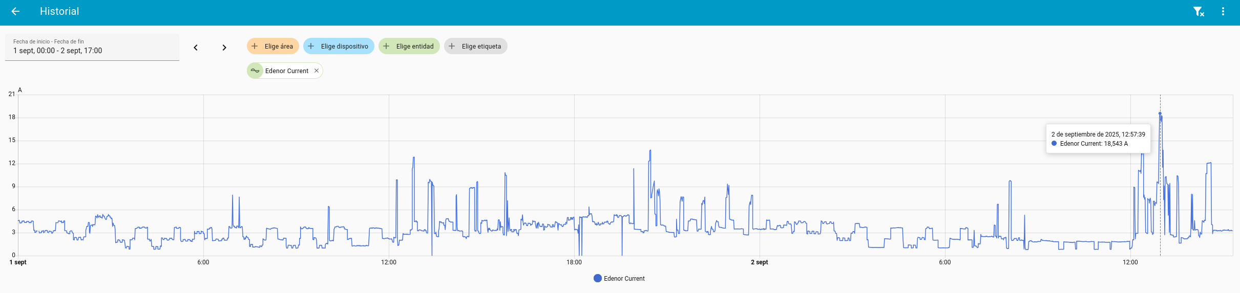

Peak current was ~18A (probably coincidence big appliances like freezer, water pump and/or dishwashing running together)

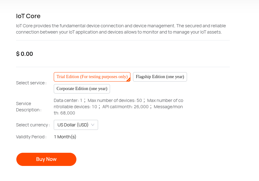

Today I checked up on my crap mail and got a reminder that my “trial” was over and I had to renew. Went to the renewal site and… well shit…
Mental note: never ever buying a “tuya” device ever again
