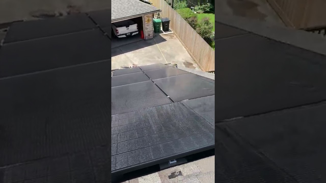

I have not, but I believe it. The solar panels actually made a big difference in the heat of the roof
The orange is where there is not a solar panel
Looks like the panels don’t get as hot as an asphalt roof too
Probably because there’s space between them and the roof which allows for air cooling below as well as on top. While the asphalt roofs have wood and then trapped attic air.
