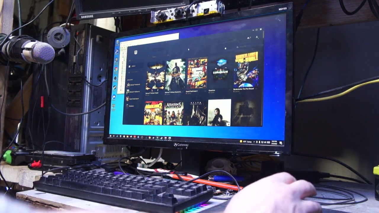

Gaming, on my Tesla, more likely than you think
i am stuck on windows bc of tarkov…has anyone ran rdr2? it always select the iGPU/video out card for “video memory limit” thing and you can’t change settings

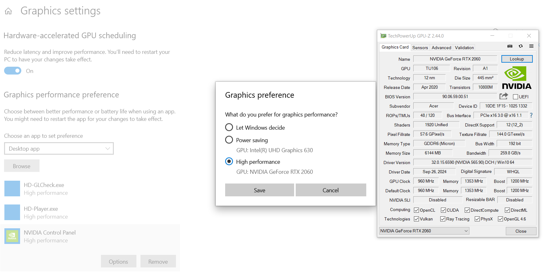

I couldn’t say for sure but since Nvidia removed EnableMsHybrid use in there later drivers
I doubt seriously it will work with a AMD card with the later drivers.
Edit: Here I installed the newest driver out for my laptop with 2060 I’m still able to pick
what video I wish to use of course. So Nvidia has reworded or put in different calls.

Edit2: I could upload the reg from that laptop if someone want to poke around?

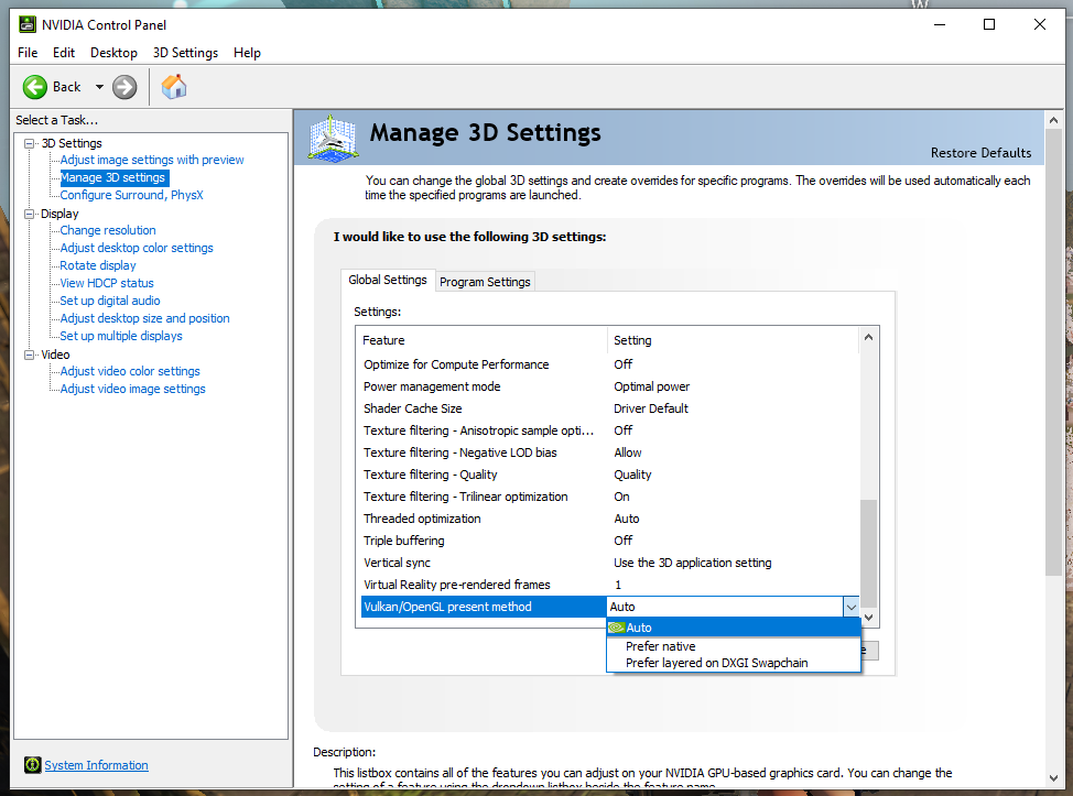

Have you ever had OpenGL games cooperate? What games never worked right with the full Nvidia approach?
OpenGL works with full nvidia, you might have to tell it which gpu to use in the nvidia control panel, there’s an option for it but Idk if that’s the determining setting
OpenGL works fine here with Quake3. Other than 1080p res. but there is a work around for that to make it work supposedly, I haven’t tried yet. Its a pretty old game and didn’t have 1080p back then. lol
