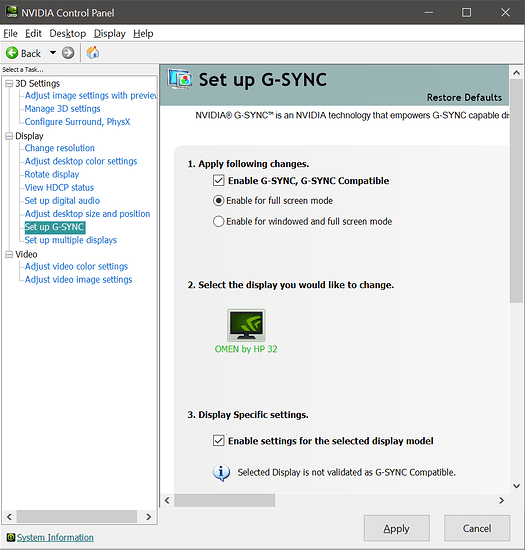

MSI reference GTX 1070 with HP OMEN 32 over Displayport.
I enabled Freesync in the monitor first, then in the Nvidia control panel. If your monitor is compatible with G-sync, the Nvidia logo will appear on the monitor in the control panel.
Sorry that was intended for the other poster. Just in case it was a 900 series or something.
