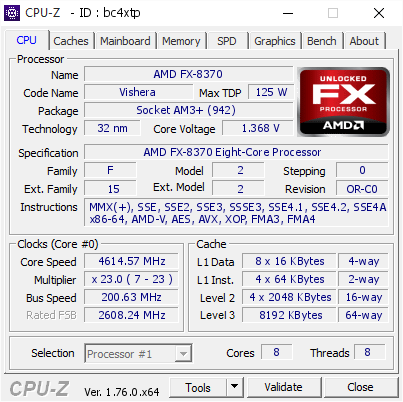

Definitely the core reason because I have gotten with stock voltage both FX-6100 and FX-8370 to run 4.4GHz and my brothers FX-6100 to 4.3GHz. I have Asus Sabertooth R2.0 and brother has the cheapest blue Asrock whatever board.
Voltage required for 4.8 runs way too hot on air, and 4.6 is still alrite +5c bump from that 4.4.
Basically FX overclock works so that you put all power savings and turbo off, then at least for me it didint seem to matter which ways I went for that 4.4 and both multiplier and fsb hit the same limit. I'm using multiplier only to get 4.6 because I dont really know what am I doing.
Seems alrite to me, like yours also jumps +5c just from the next voltage bump with 4.5, 4.6 probably throttles within moments in that Prime95. Don't know if it makes you feel any better, but you are just one multiplier behind the chip I have.
