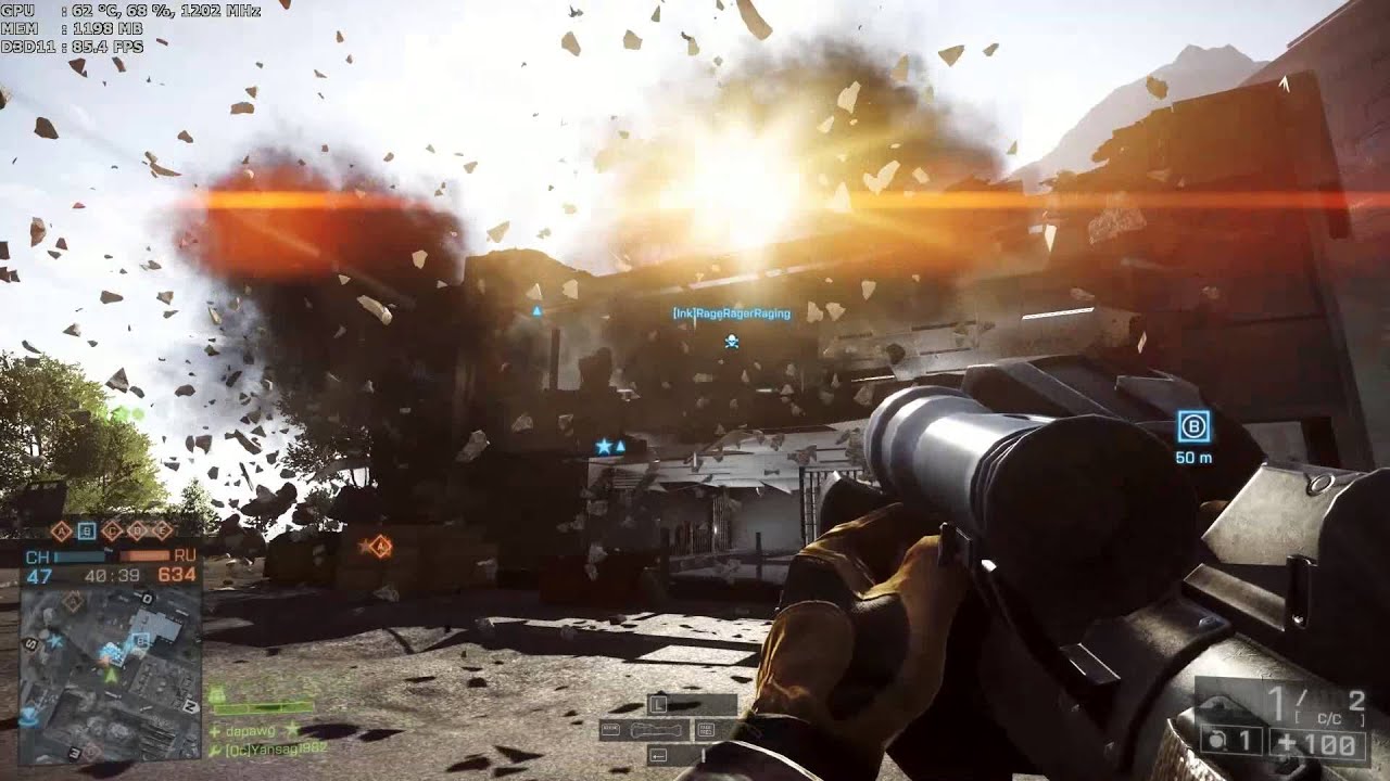

Here is a video from a Guy on LTT community who posted this video about BF4 multiplayer on a FX8320 + 780.
Your scores are indeed low according to this.
Ah wait you are the exaly the same guy who has started a topic on LTT aswell.
lol cool. ☺
Yes I did lol.
And btw, his 780 is OC'ed, though im not sure how much over stock. And his 8320 is at 4.4 ghz. I just tried Lancang Damn at ultra settings and averaged 105 fps, with a max of 125. I suppose I am getting similar results. However, what concerns me are the temps.
