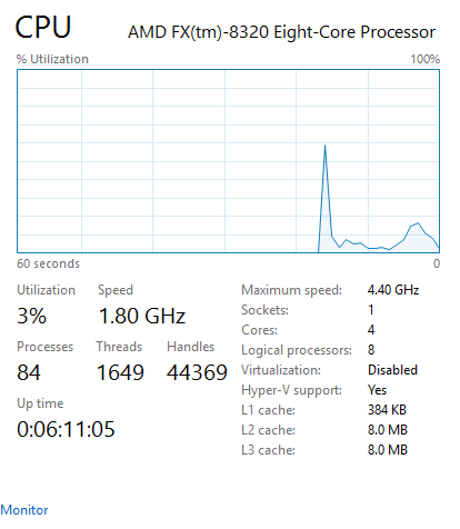

I got it running fine now, 4.0 ghz, 1.2v

Lowered the voltage and I actually was able to raise the oc.
That's a pretty good voltage. You might be able to get up to 4.4-4.5ghz on ~1.35v, if you continue to be lucky.
Already ahead of you.
