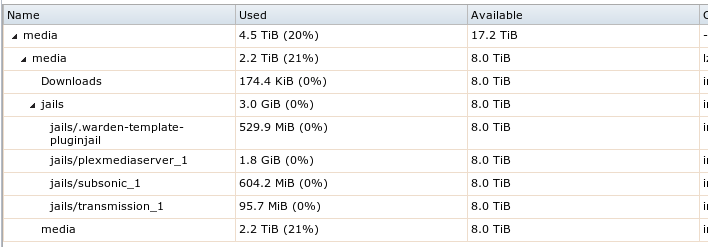

Ok so, I'm looking at the storage screen of my Freenas box and for some reason I can't comprehend a missing 2.3 TiB of space. For reference and so that we can all laugh at whatever small mistake I'm making here is my storage:
first the Used and Available of the first row makes sense I have 4 6TB drives in there.
However, if I add up the used space I some how can't get it to total 4.5 TiB. I know media shows up twice at 2.2 TiB each time, do I add them both in? is one a backup copy of the other? am I suppose to have that backup of everything? For the record I'm running Raidz2 and this is the first Freenas box that I have setup.

Right, so you need to zoom out a bit from that screen shot and look at the compression. FreeNas will compress files on the fly too save space, which is likely where the extra file size is coming up, with less actual used on disk.

when I look at compression it is all relatively low between 1 and 2 % for each of the areas.
I now think I understand why I have 2 media partitions, each taking up 2.2 TB of space. When I originally started this project I had a windows computer that was storing all of our pictures/media files. so I created a CIFS share so that I could move all of this to the Freenas box. After getting everything safely stored on the freenas box, I upgraded to Linux and created a NFS share so that I could access the data.
I still have a CIFS share so that my wife can access all the pictures/media and I'm wondering if Freenas is just duplicating the data between the 2 shares, even though they are suppose to be pointing to the same directory on the Freenas box?
