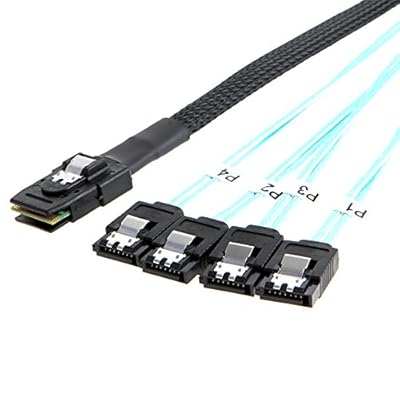

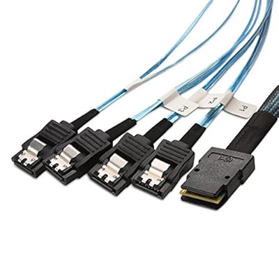

For the mini-SAS cables, get 2 of either of these depending on length and connector preference.

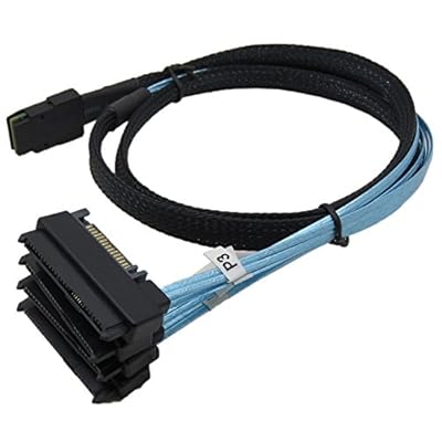

You can also get these. I would recommend these because they don't lock you in with SATA only, they also work with SAS whereas the cables above are for SATA only (or a backplane).
This cleans things up and depending on your power supply may be necessity.
You can of course get a different brand or order from somewhere else. At the minimum you need 2x SFF-8087 mini-SAS to 4x SATA breakout. They make all different kinds of cables for all kinds of applications.
