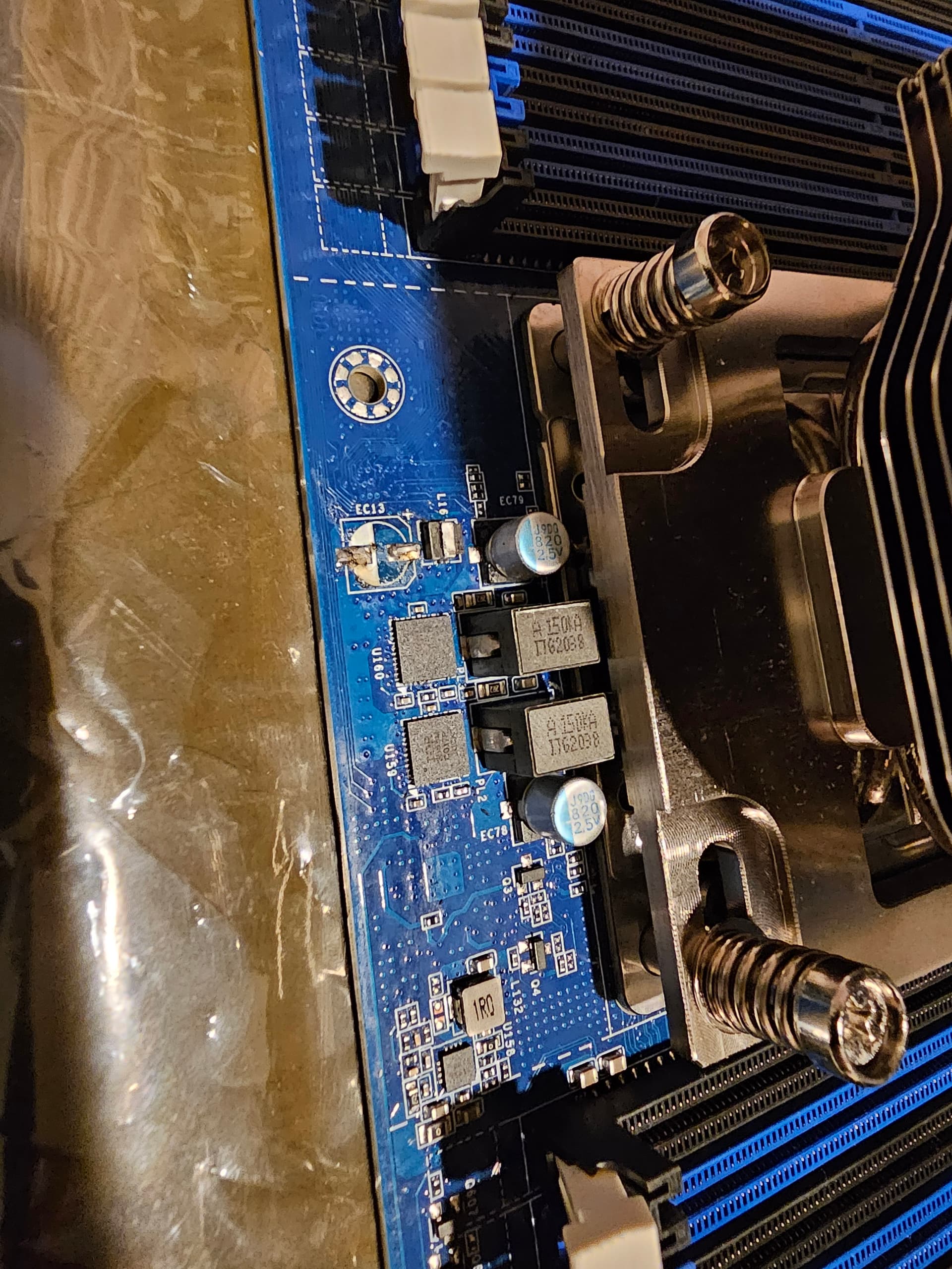

I recently got a used mz32-AR0 board and running a epyc 7C13 and only have 1 stick of 128gb 2933mz ecc lrdimm in the system at the moment. But on tasks where I should normally be getting a constant cpu utilization it is fluctuating quite a lot.
My motherboard is also missing a capacitor so trying to determine if the capacitor is causing the issues or the ram. I uploaded a image of the missing capacitor if someone has the same motherboard mz32-ar0 and can send a close up image of that capacitor so I can see the values and get a new one that would be great.
This is the first server I have built so any advice would be appreciated.

Disclaimer: I don’t have this board.
Given the fact there’s 2 equal capacitors still left, I’d suggest getting one of those to replace the lost one. Mind, it looks like the old one came off with its pads still attached, so you may not be able to solder the new one to the board.

While writing, what happens when you are using a synthetic stress test like prime95?

I’ve attached an image of the capacitors below
Thank you for the picture, I think I might refund the mother-board as the component above the capacitor also looks damaged.
I ran occt stress test and with the test running for 14mins i got a HWEA error. I have also ran pass-mark performance test and was getting really bad scores in prime numbers and physics all the rest where normal.
I am currently running prime95.
For all tests it’s using full cpu utilization with no fluctuating
