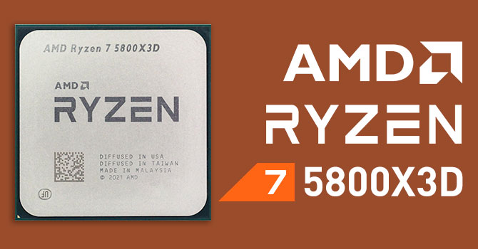

Yes this is an older review, but solid benchmarks on a RTX3080 to show that it has a large impact for most gaming workloads.
