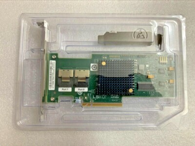

Get an HBA for SAS drives;
Get two of these to connect 8 drives;

The advantage of the right sized case is you can put a lot of great value gear inside. Buying cheap 3TB drives rather than expensive 6TB drives is now easy. SAS drives are similar to SATA but cheaper and require special cables and card to make them work. Don’t get RAID but HBA card.
