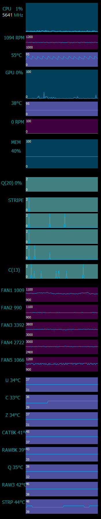

If you’re up for it, just skip the case controller entirely and plug all your fans directly into the board with splitters. Less hassle, more control.
I use Corsair Commander( 6 fans) & ICUE works with all PWM 4 pin fans. You will Probs need corsair USB 2.0 hub as there isn’t many of them on mobos these days. ICue my screenshot.
yah, i don’t care about the case controls.
Yeah Define XL has its own hub but i took it out and replaced with the above

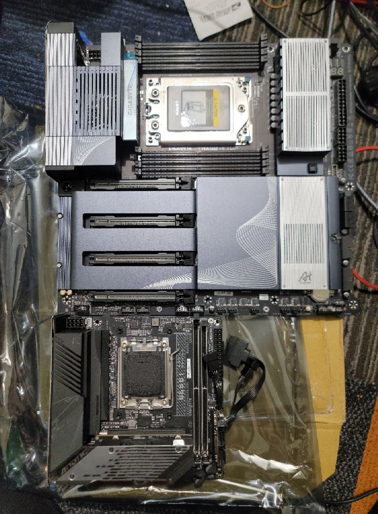

The manual says “The PCIX16 slot can only support a graphics card or an NVMe SSD. If only one graphics card is to be installed, be sure to install it in the PCIEX16_1 slot.”.
I’m not clear what they’re trying to say there.
I assume they mean “PCIX16_1”, not “PCIX16” since “PCIX16” doesn’t mean anything to me in this context.
I’m currently running one of the NVMe x4 PCI adapters in PCIX16_1 (but currently with only one module populated), and the GPU in PCIX16_4 since that slot has a little bit more clearance for airflow.
So far I haven’t noticed any ill effects of the GPU where I have it, but I guess the jury is still out till I add more modules on the card. :thinking:

so after all these years of building systems, this is the first time i added leds (or a window) :rofl:
so after i sorted out all the fans and they’re all idling nicely… it’s still loud!
so i find the culprit
these suckers are loud :joy:
so i disconnect the fans. i wasn’t even using the adapter’s heatsink for two of the units, and considering the sound, i figure the big hunk of aluminum is probably good enough without the fan
so now we’re nice and quiet.
