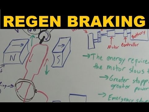

While its not the same thing, car manufactures already do use something similar to what you are talking about. Its called regenerative braking.
